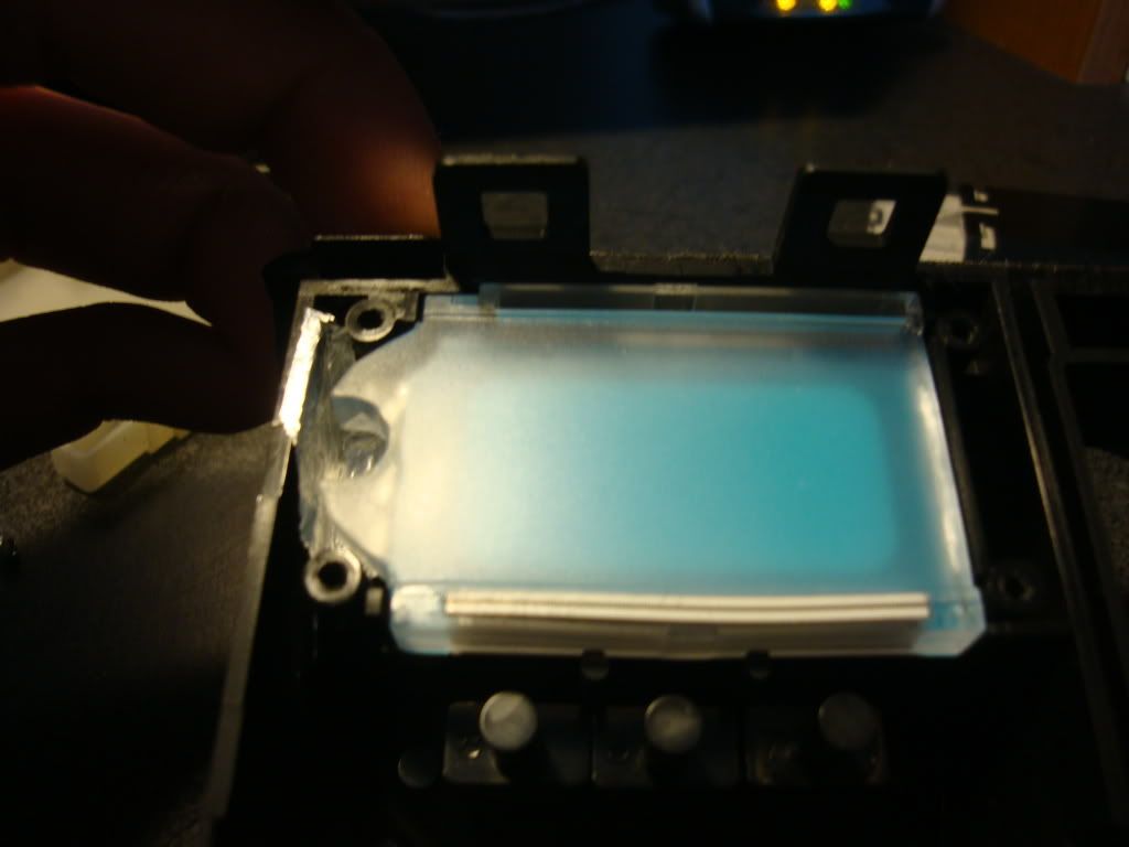

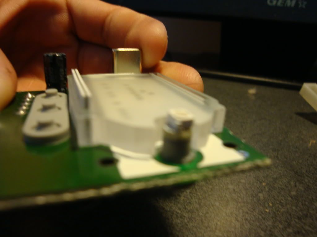

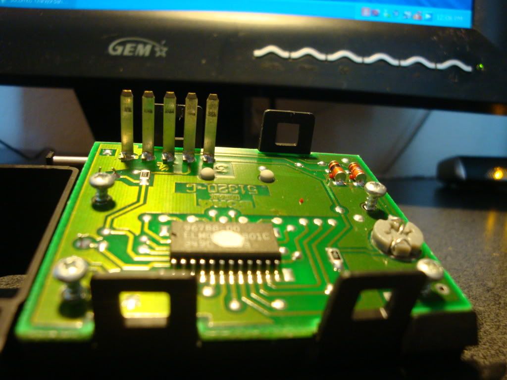

aight i took pics
this is why these leds dont work the led is too long for the frosted piece of plastic to catch light to diffuse light evenly across the clock
to fix this all u need to do take apart the clock
remove the white platic cover
then remove the four screws (i took the hazzard switch out for more space)
once the screws are removed separate the circuit board from the clock housing
now pull all of the clock screens away until ur left with this and neatly slide a piece of alum foil inside the slit like so
now put everything back together and enjoy the greatly improved light output
hope this helps
rep pts will be greatly apreciated :peace:

I just finished adding the foil and it made a big difference. The entire clock is lit up. There is a very small dark spot to the right of the last number that is a bit darker then the rest of the clock. I think that's a result of the bulb block the light that is being reflected from the foil. Or it might be because I'm running an amber LED. But it's not big enough for me to cause a problem. It's better than nothing. I'm FINALLY DONE with my LED conversion now. :thumbsup:
A side note: I accidentally left the light filter in on the first attempt so make sure you remember to take that out. I didn't take a picture because my camera quality is so crappy you wouldn't be able to tell it from the stock lighting.
