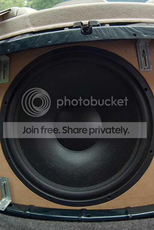

sorry but im still confused. are the speakers mounted flush against the rear seat? or is that a panel and the seat is folded down. how does the bass enter the cab of the car? ive seen some fi ib subs for cheap. lots of xmax to
you can mount 1 15" right up against the seat. it wont quite fit into the opening. if you want 2, you'd have to either mount them further back or put the cones towards the trunk (doesn't matter much). one is enough for me, but i'll probably add another down the road just to get more of that lowest octave.
i probably lose a dB or two with the seat up, but riding around with the back seat folded was high school **** :lawl: the armrest doesn't make any difference if its up or down.
the biggest thing if youre going to do it this way is watching out for the folding pass-thru...it sticks out a LOT on the trunk side (the little pull handle thinger).
nevermind the wires and hardware...first pic i only had 4 screws holding the baffle and no hardware holding the sub :lawl: theres a few more things holding it besides the brackets you can see...

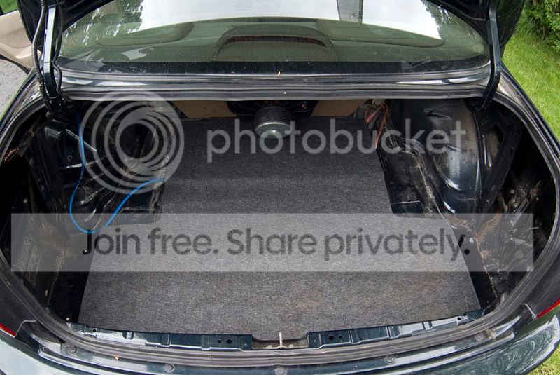

oem carpet is back in...trunk "floor" is getting redone in 1/2" birch ply as we speak...
you must seal up all the big holes/holes you can see through etc...very important...
