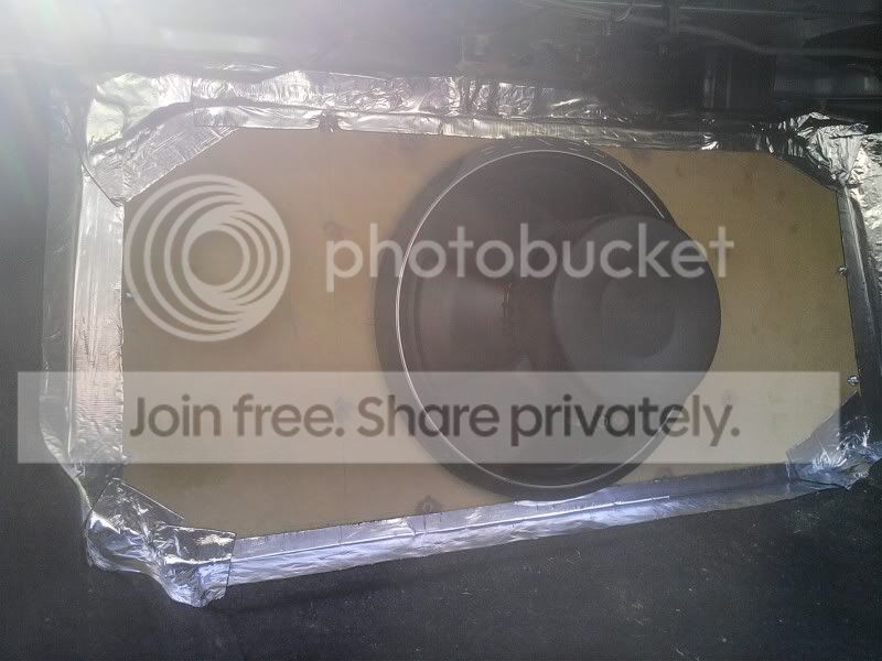

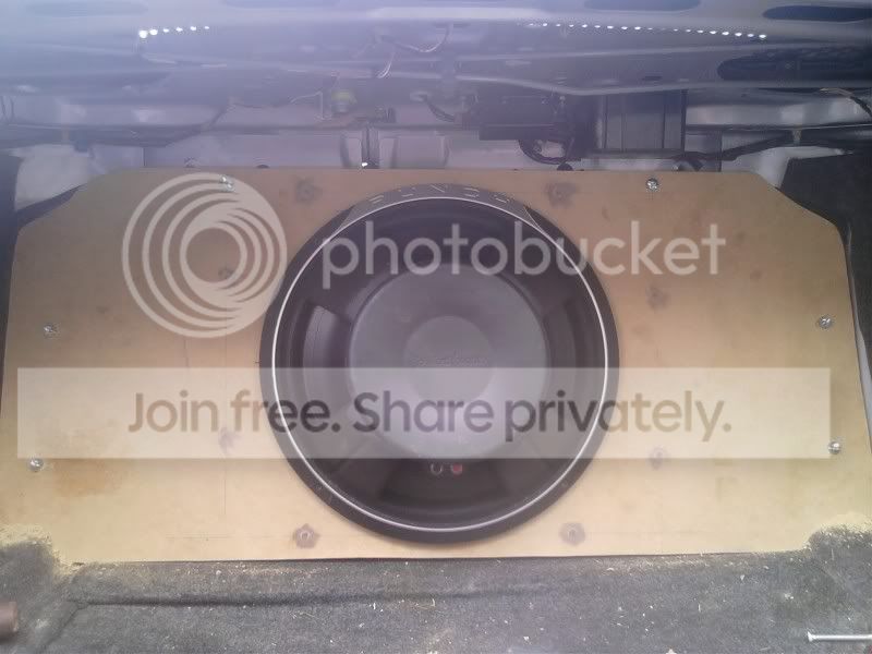

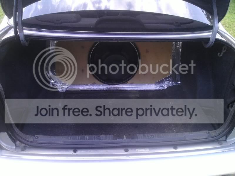

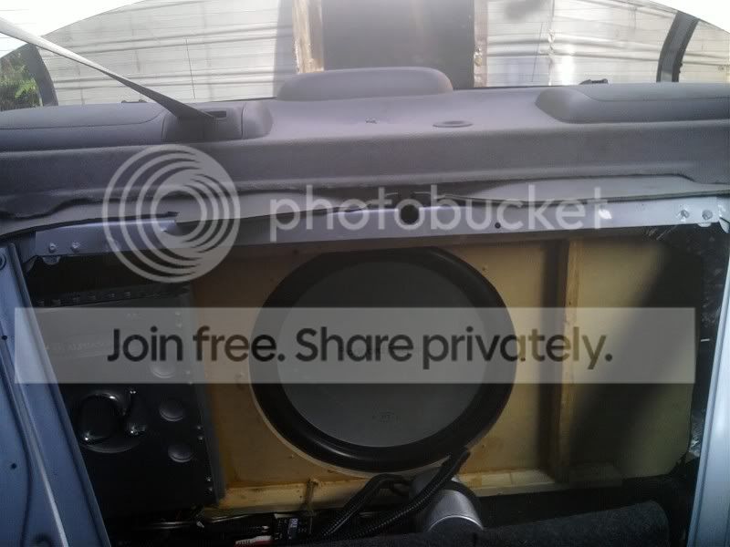

It sounds ok. Its obvious that this sub is not made for this setup. Can't wait to get the right sub for it. I plan to cover with carpet once I finish it. I might throw my original box back in for now. What do you guys think? Looks ok?

not bad at all...probably a lot simpler than making a 6-sided box, right? :lawl: and a LOT lighter.
is there any movement of the baffle at all?

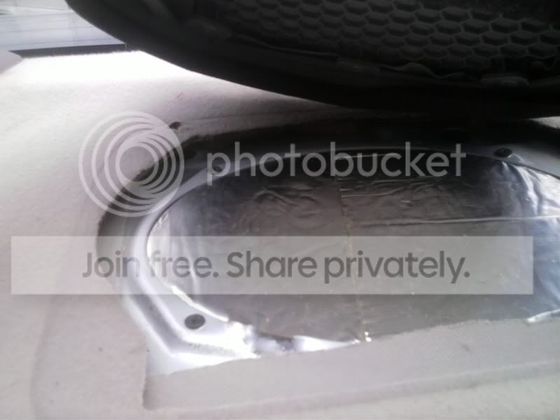

you may not feel the need to do it, but i did...take a rag/old tshirt/block of soft foam and shove it into the holes in the very upper and outer holes of the trunk...right above the shock towers. theres a 3x4" gap on each side...i've never tested if it makes a difference, but i shoved some material in there.
also consider using something small to plug the seatback latch...you can see light through it, so best to plug it.
nice work (and quick too) ;)

that is begging for 2 15's
Na, I think one will do. I just listened to some rock music and the bass guitar and drums sound so much more accurate. Rap dosen't bump like is did before but that should improve with the new sub.

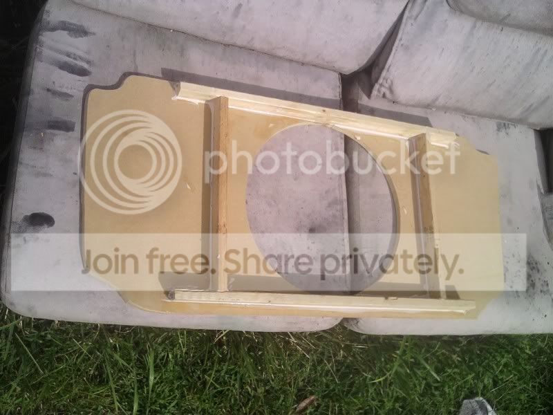

Yes, a whole lot more simple. There is a little movement in the baffle at the bottom. I just need to get a long enough drill bit to bolt down the bottom. Everything else is real solid and it dosen't make any vibration noises.
Wow nice cutting skills.
Thanks! I had to make a couple of templates but it worked out just fine.
