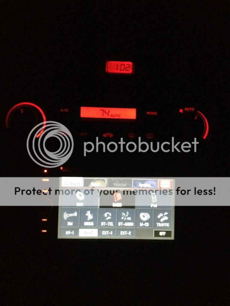

I couldn't wait any longer and just finished installing my new Avic D3
Sure there's no trim around it and I forgot to wire the parking brake bypass correctly, but who really cares? It's a big shiny touch screen! :lawl: That being said I'll fix those things tomorrow after a short shopping trip
P.S. The LEDs and lights on the headunit look much more red in person

...I forgot to wire the parking brake bypass correctly...
correctly? why the **** would you do that? :lawl:
Just splice the wire into the ground so you don't have to pull the ebrake every time you wanna watch something.
for pioneers you have to use a relay. its easy
Haha that's what I did, and it still wasn't working :squintrun:
I've heard some people say you need it and others say you're find without... not sure since the unit is a few years old. Researching on avic411.com

Figured out the Pioneer brake bypass. I'd been trying to ground it by splicing into the black wire on the harness, which wasn't working, so I just grounded to some metal behind the dash and it worked. Now I just need to pick up/ download and burn some navigation discs and I'll be set :rock:
i know with the avh3200 which i have, to bypass it it needs to be grounded after the unit turns on. so you use a relay and the remote wire and it works.
glad you figured it out :peace:
