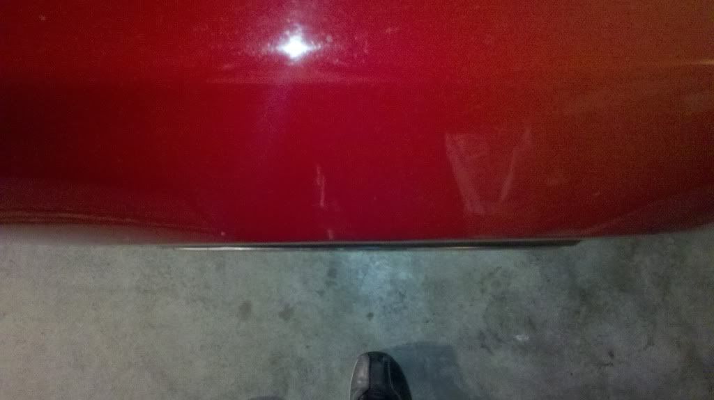

Okay, so I test fitted the wheels tonight...and I have 2 concerns:
1) The fronts poke a little, and if I want to pull these off I would either have to do less tire stretch or lower the car more.
2) Not sure my BBK will clear front wheels or not. Which possibly means I would have to choose between BBK or wheels.
So, here are photos. What do you guys think about the fitment? Sorry, this was kind of a last minute thing and I didn't have my camera on me.
Again, wheels are 18x8 +38, and I'm lowered on Sportlines and Yellows (lowest perch in front), with roughly 1.5 finger gap all around with my A-Specs.
FRONT:
REAR (perfect for me):

Get a 225/40 on there and it'll look good. That tire on there looks like a 215? Do you have a camber kit in the front at all?
19,517
118
^Yeah they have 215’s, I wouldn’t mind having a little stretch but what’s pictured is too much and I’m not slammed, so the front looks bad lol. Rear looks decent.
I do not have a front camber kit, you’re saying that would fix the poke? And would you go as far to say that giving the front a little camber would allow me to put a spacer in to fit the BBK? Not sure how big of a spacer I need though, so if I needed a 10mm, that may make the wheel still poke…not sure. I guess I need to really test fit these with the calipers on.

With a lower drop, the camber will compensate enough so that the wheels won't stick out as much. If you are happy with that, then, you're good.
If you run a camber kit, then you can obviously control how much camber you have in the front.
Wider wheel + plus lower offset, should get you around when your current wheels are, depending on the offset.
The spacers with those new wheels will push them out too far, IMO, and if you already don't like stance, pushing the wheels out further will not help, and a camber kit won't help that either.
So, you may have to consider a different wheel, if you are set on running the BBK.
