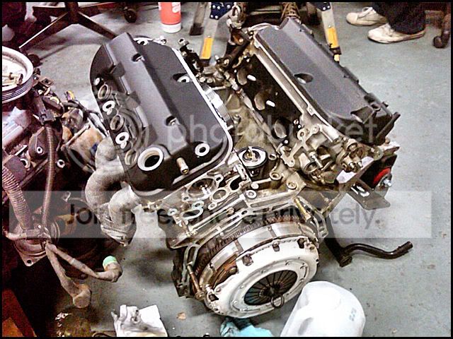

everyone is doing a M/t Swap.. so LETS GO BIG OR GO HOME :fail:
The Build

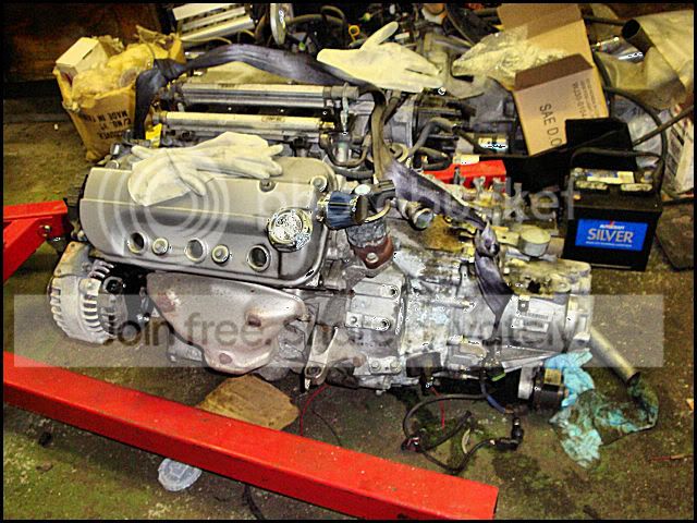

• 2003 CL-S motor
• 2003 CL-S ECU
• 2001 Odyssey crankshaft
• 2001 Odyssey connecting rod bearings
• 2001 Odyssey main bearings

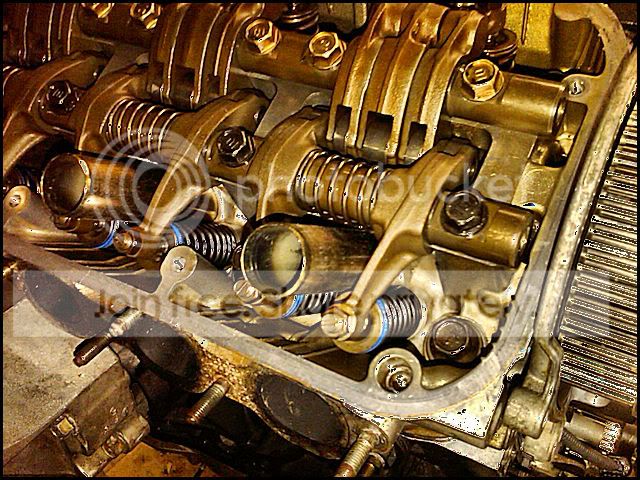

• 2007 TL-S Exhaust Valve Springs
• Unorthodox SS Racing Pulleys
• Fujita Cold Air Intake
• XS-Power headers
• Innovative Motor Mounts (Cut and Lowered)
• Corsport Aluminum Shift Linkage Bushings
• CL-S Engine Harness
• DEI Exhaust Wrap
• P2R Power Plenum
• Walbro 255 Fuel Pump
• Aeromotive Fuel Pressure Regulator
• Magnaflow Highflow Catalytic Converter (being supplied)
• 3" Magnaflow Resonator
• 3" Magnaflow Muffler
• 2.75" Piping (being supplied)
• Custom Made Cluster LED/Gauge Setup
• Custom Single Pod Steering Column Cover
• Custom CD Tray Toggle Panel
• Omni-Power EK Civic Quick Clutch Master Cylinder
• Mugen Thermostat
• Mugen Fan Switch
• NRG Torque Damper
• Oil Catch Can
• Oil Cooler
• 97Accord Mishimoto Aluminum Performance Radiator
• 97Accord Mishimoto Fan Shroud
• 97Accord Mishimoto Slim Fans
• 97Accord Mishimoto 1.3 Bar 19lb Radiator Cap
• Spoon Magnetic Drain Bolts
Suspension
• TASauto.com Rear Lower Tie Bar
I.C.E.
• Prosport Oil Pressure Gauge
• Prosport Fuel Pressure Gauge

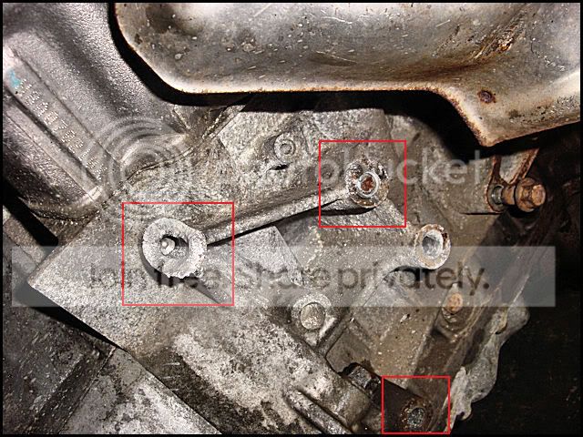

Reason For Swap J30 Cracked where rear mount bracket bolts on

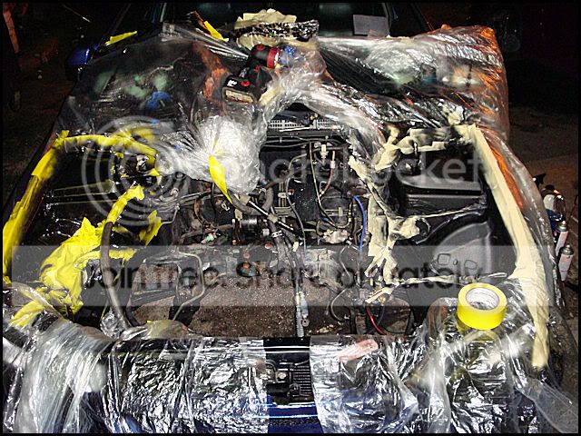

Painted Engine Bay Flat Black

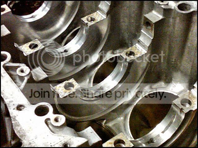

Machine and Honed Engine Block
'07 TL-S Exhaust Valve Springs

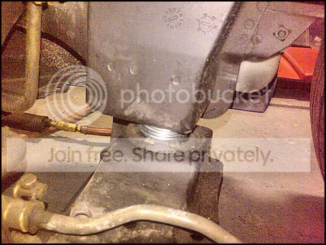

Shimmed Engine Cradle
Old
New
just a thread to keep you bitches updated :coffee:
