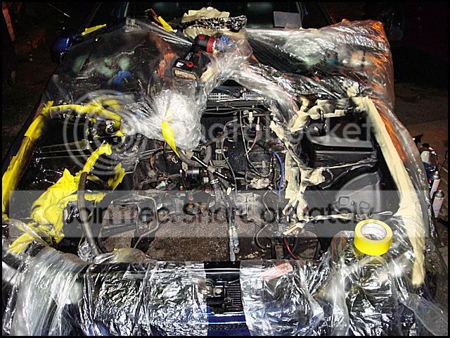

Flat Black'd the engine bay

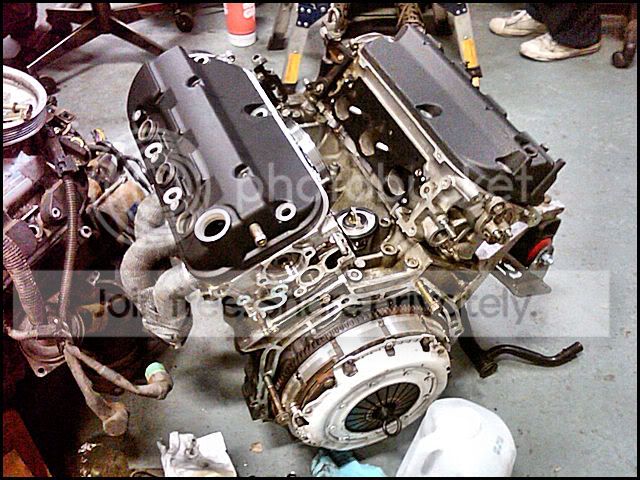

Block back from machine shop

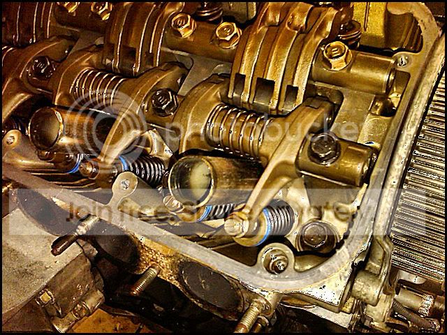

Head coming together(07 TL-S Exhaust Valve Springs)

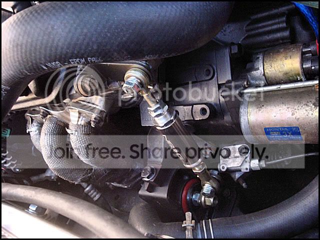

Cradle Shimmed for hood clearance (along with cutting the Innovative mounts)
new heart
a peak at my Omni-Power clutch master cylinder

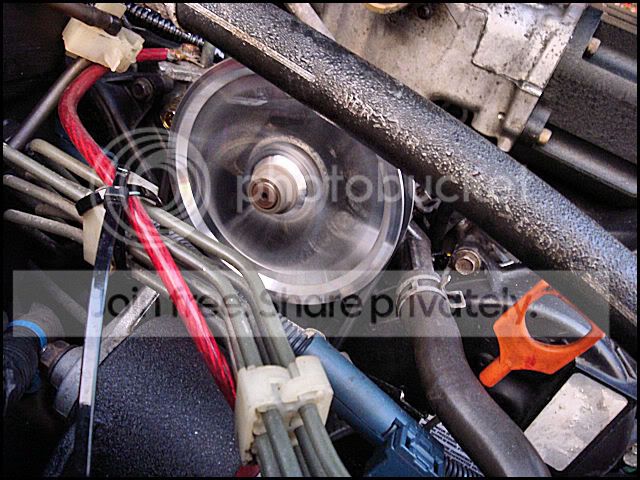

UR UnderDrive Pulleys
Oil Catch Can

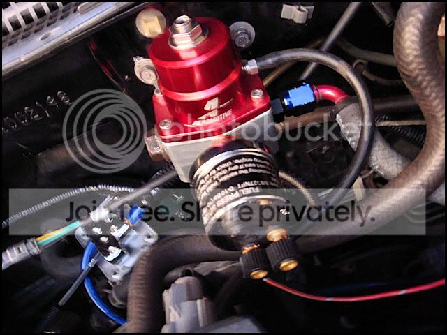

Aeromotive FPR (walbro 255 fuel pump in tank already)
NRG torque Damper and Innovative mounts

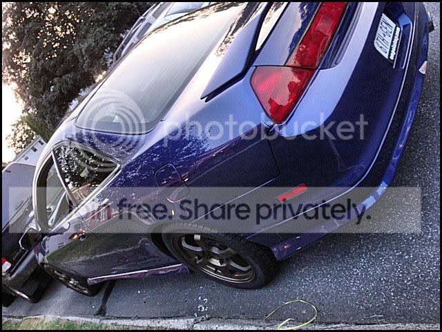

Put the wheels on too, Im not crazy about them tho :(
