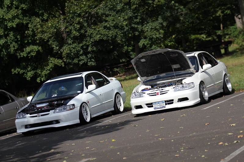

some pics of her at Import alliance at ripken stadium
