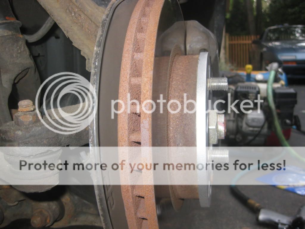

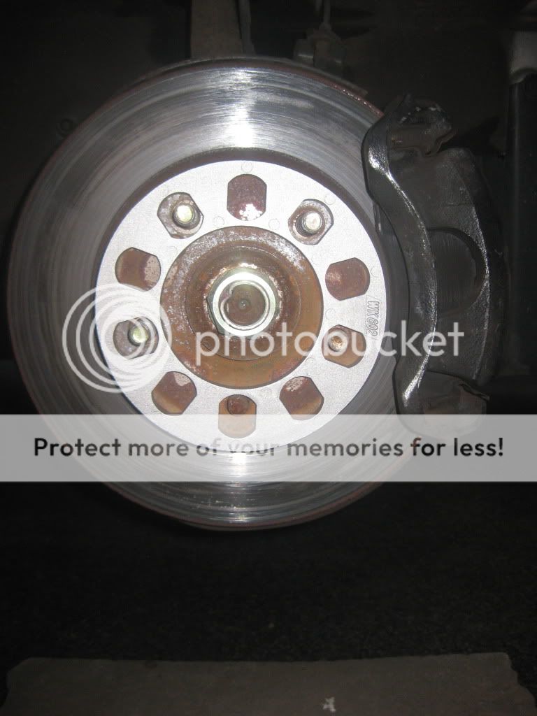

Re: 07 civic si wheels : /
here are some pictures of the 5/16" spacers(missing 2 studs on one side)
on the car
front
