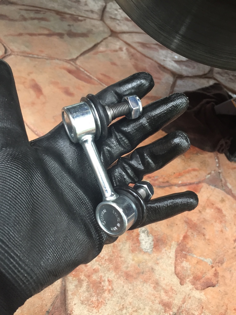

As I mentioned on another thread I resolved the popping noises by replacing the front sway bar end links.

Always feels good to get rid of rattles/creaks/pops/squeaks. What kind of endlinks are those?
