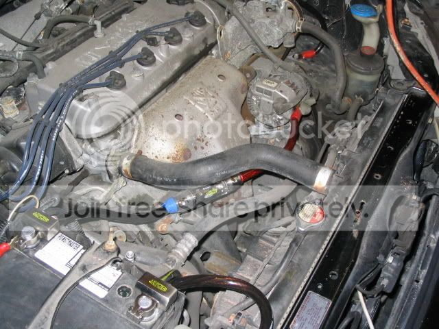

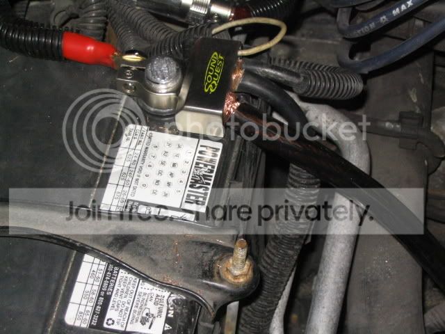

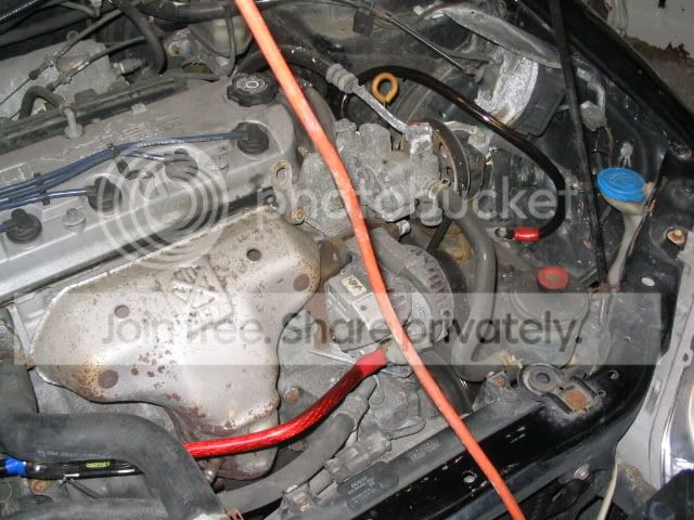

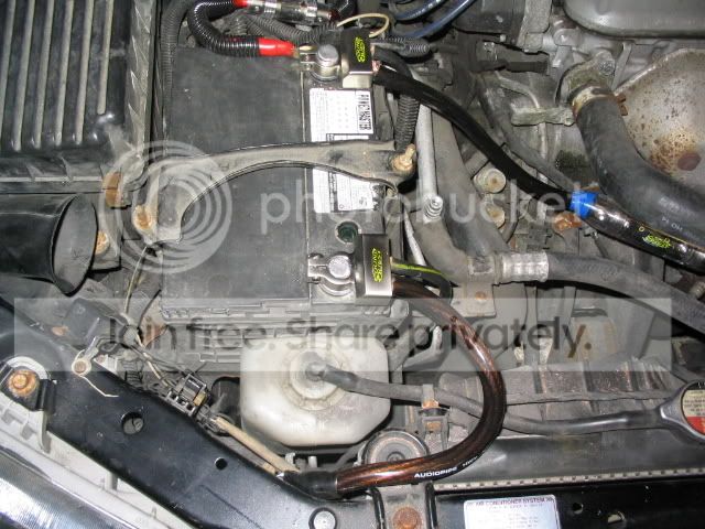

Did the big 3, I am had trouble putting the 0gauge in the 0gauge terminal slot, I did put it in but some strands are left out squishing up againts the terminal it doesnt look clean but Iwas wondering if this is ok and or safe?
But here are the pics (one showing what I am talking about above. w/ the terminalslot and wire)
The wire pushing up againts the terminal..
champaned_out
Nov 20, 2005
437
i would at least put some black electrical tape around both wires for safety reasons
and also on another note, that has got to be the dirtiest/oldest looking 6th gen engine bay ive ever seen... what happened? every nut and bolt looks rusted in those pictures
how's that wire doing so close to the heat shield?
mine's a couple inches further away and is fine, but you're looks really close.
maybe some loom would be in your best interests.
