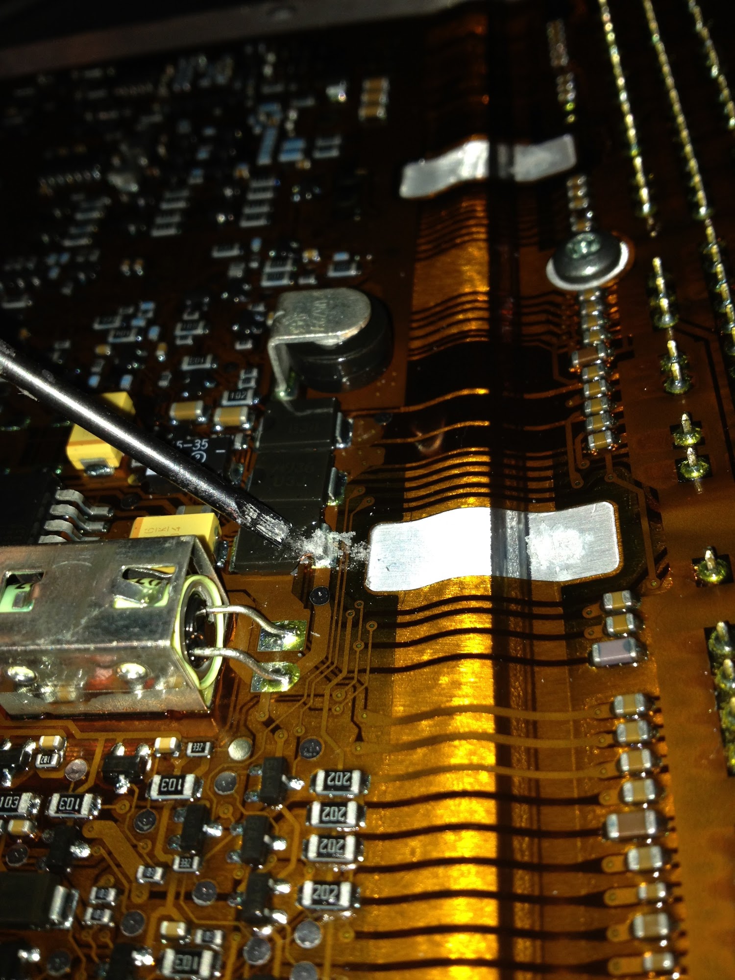

So I removed the ECU and took it apart and I found a broken component that I believe is the one causing my trouble.
Does any one know what component this is? I can solder on a new one if I can find the component. Or if anyone has a bad ECU that I could transplant the component.
Also, is this something that Honda should be liable for? This is ridiculous that the component would crack off like that. That clear stuff scattered around is a clear protective layer that was applied on top of all the electronics.

You can always try and take it up with your closest honda dealer. I'd say just JY hunt for a matching ECU and swap it in.

So I found out that part is a power rectifier. So I am either going to try and find an exact replacement or try to find a broken ECU.
