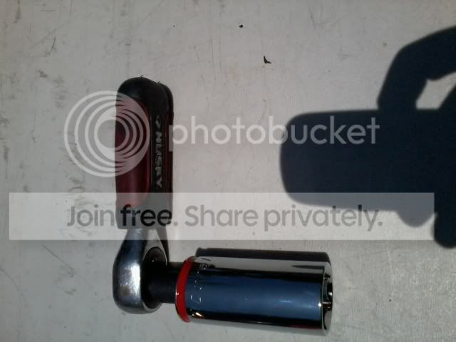

This is what I ended up using.
(Short/Stubby) 3/8 Ratchet.
1/2in to 3/8 Ratchet Reducer.
27mm Deep Socket (1/2in).
It's all I had to work with because the auto parts store did not have a 27mm Deep Socket for a 3/8 Ratchet which is ideally what you'd want to use. If you don't use a DEEP socket you WILL break the plastic connector on the sensor and you will be ****ed. You can access the sensor from underneath the car but please use jack stands. Safety comes before anything. Walk the new sensor in until it seats on the block. Then put the 27mm DEEP socket on the sensor first followed by the ratchet with the reducer (if applicable) and then tighten it. I don't know how many ft lbs (not like you can fit a torque wrench in there anyway especially with the oil filter in the way) but I just tightened it about a quarter turn. Pretty simple thing to do I know but it's a damn expensive sensor and I want to give people the heads up before breaking a new sensor and having to buy it twice over.
