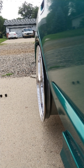

- finally refinished my BBS LMs 17x8 +30 17x9+27 (reverse mounted to get more aggressive offset, hand polished the lips, painted inside barrel black, powdercoated the faces silver, and finished it off with 24k gold hardware)
Side note: can't run these wheels yet since they don't clear my BBK now in the current spec shown above...since the faces have different offsets, I'm going to run the more agressive face (+27) in the front and resort to using a spacer in the rear. [New wheel specs will be 17x8+27 and 17x9+30. See pics below for difference in fitment] There's a rust bubble on the rear fender so I need to shave the fenders instead of rolling them so that'll happen over the winter or in the spring of 2021.
