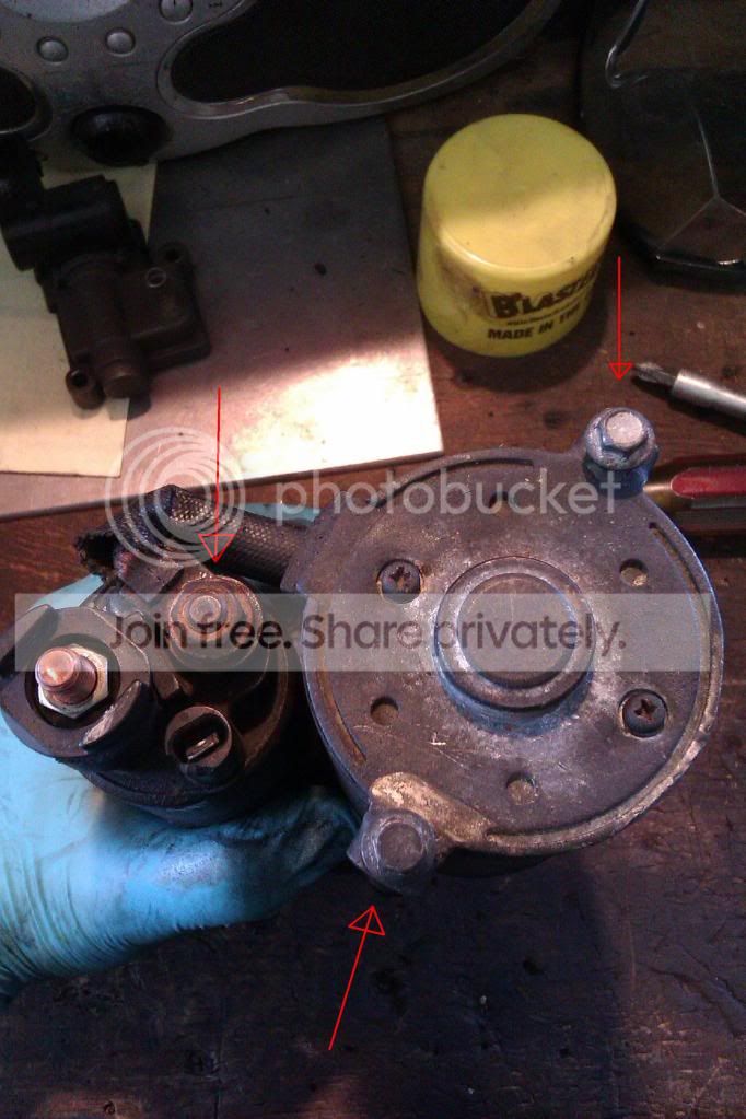

Step 2: Remove the 12mm nut holding the wire to the terminal. Then remove the two long 8mm bolts holding the housing
down to the whole starter.

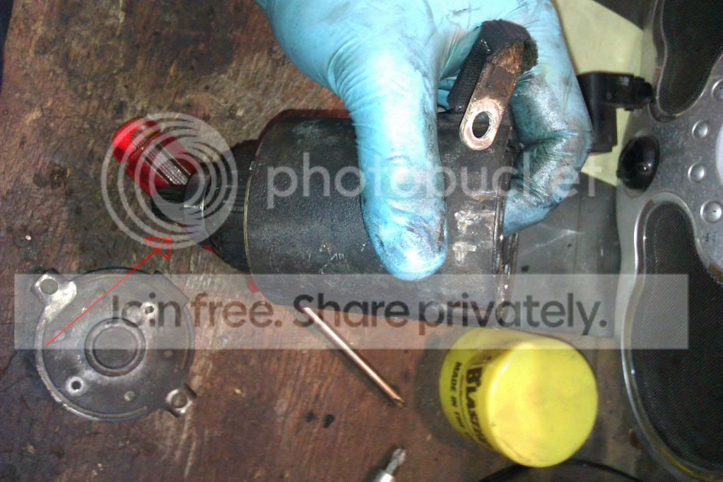

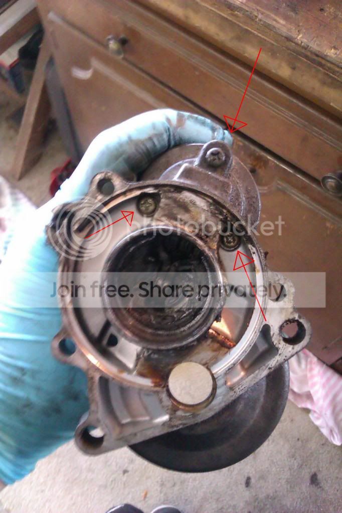

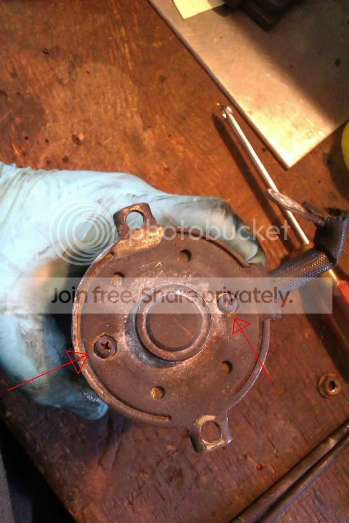

Step 3: Grab a size 2 philips screw driver and remove the two screws on top of the housing.

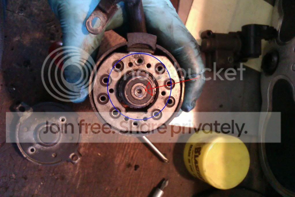

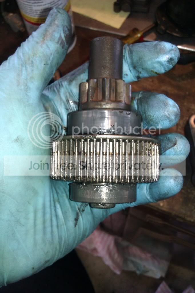

Step 4: Remove the piece highlighted with the blue circle. Next push on that little wheel on the top and pull on the
gear at the bottom to remove the piece from the housing.

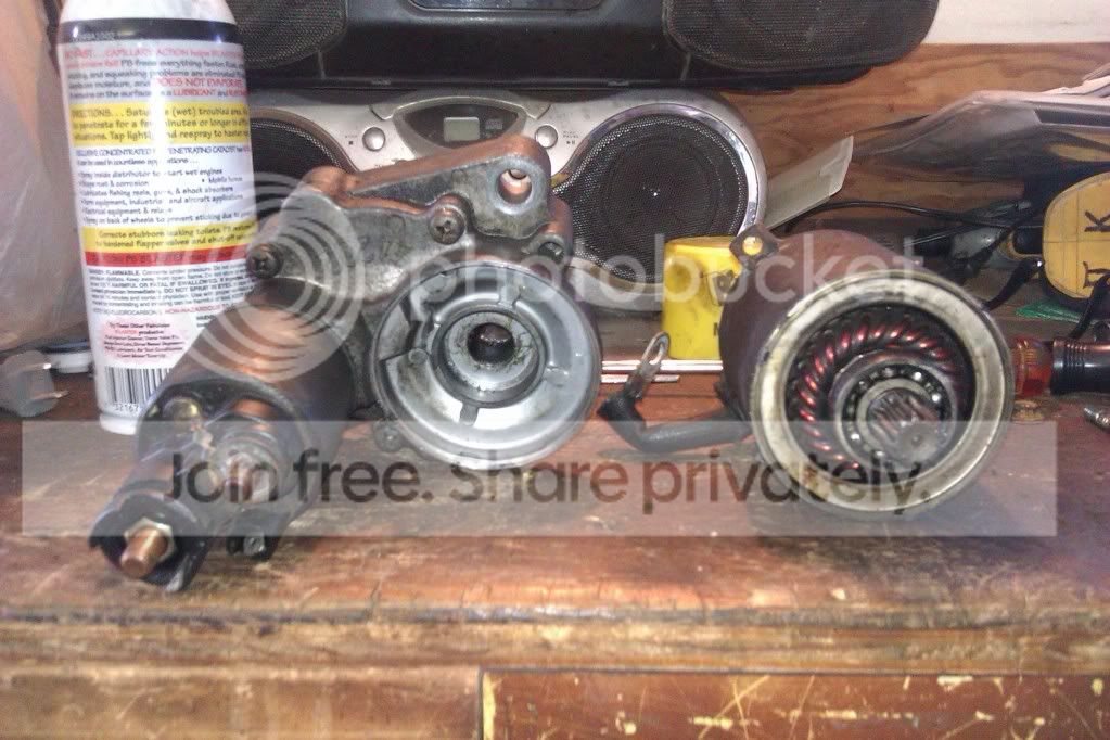

Now conitnuing on to the removal of the solenoid that pushes the plunger out.

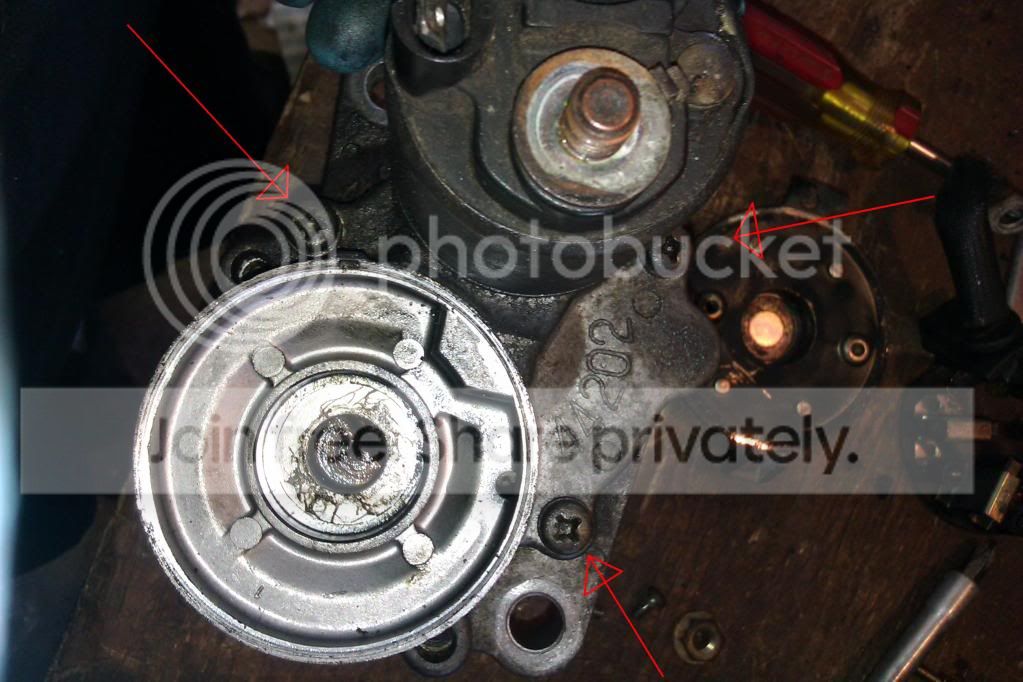

Step 5: Spray the three screws holding the housings together. And use a size three philips screw driver to remove them.

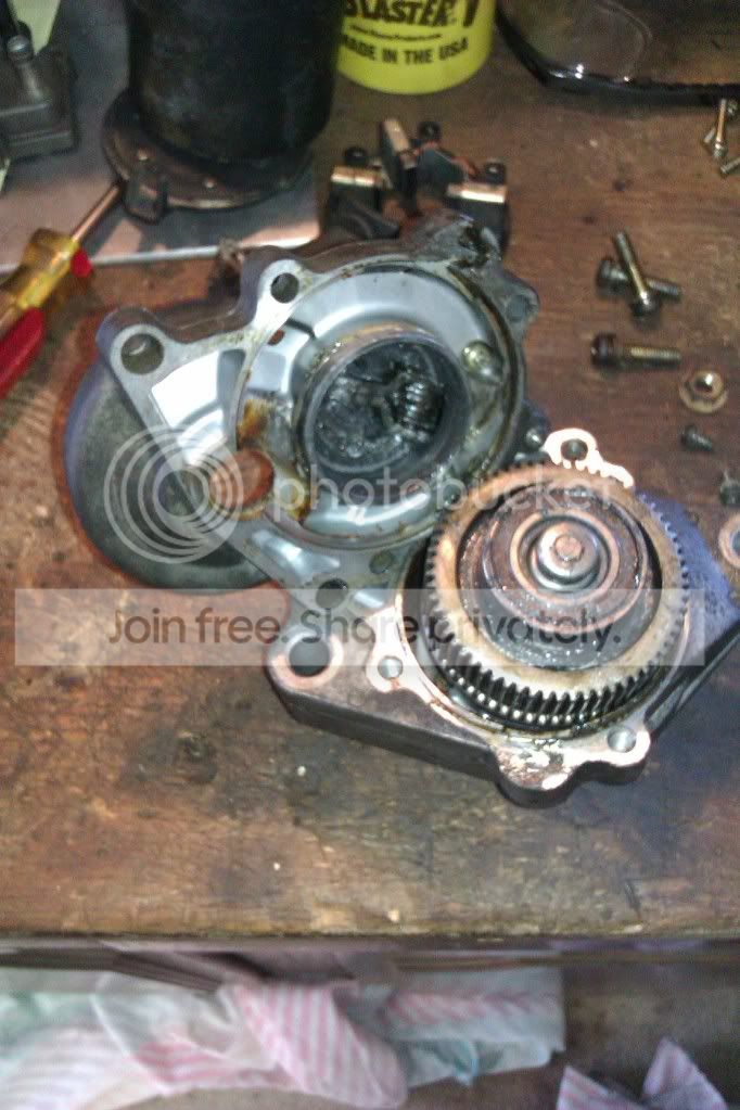

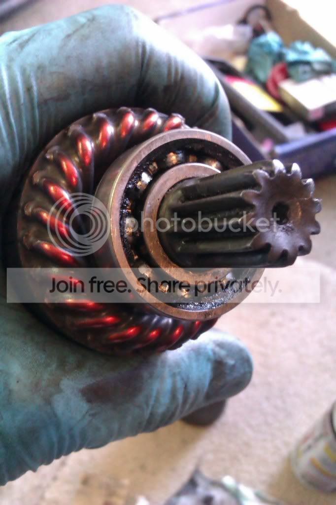

When you pull the housings apart make sure to pull the plunger/gear assembly out for cleaning and lubing.

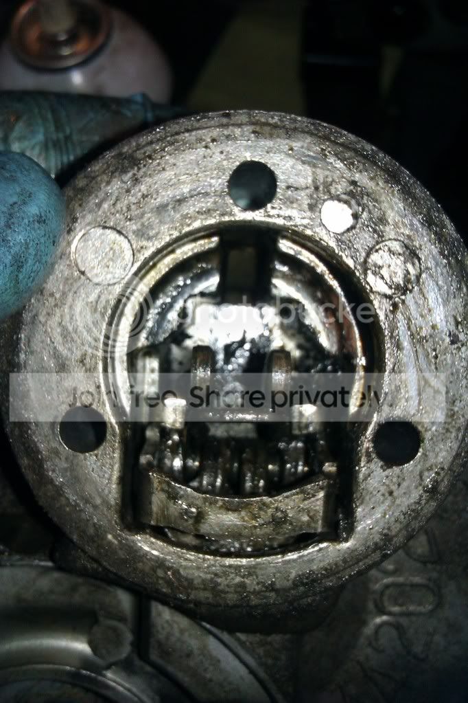

Step 6: Remove the three screws holding the solenoid down.
NOTE: There is this little metal clip assemlby that held down by the solenoid. Make sure you remember the positioning of it if it falls out or when you take it out to clean it of all the grease.

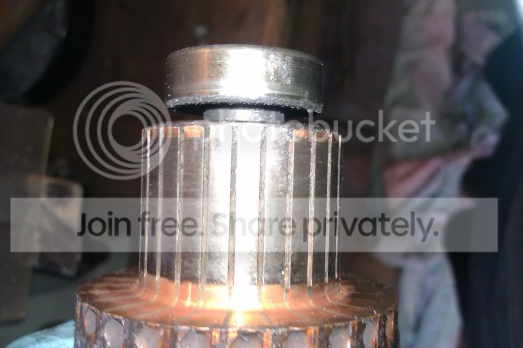

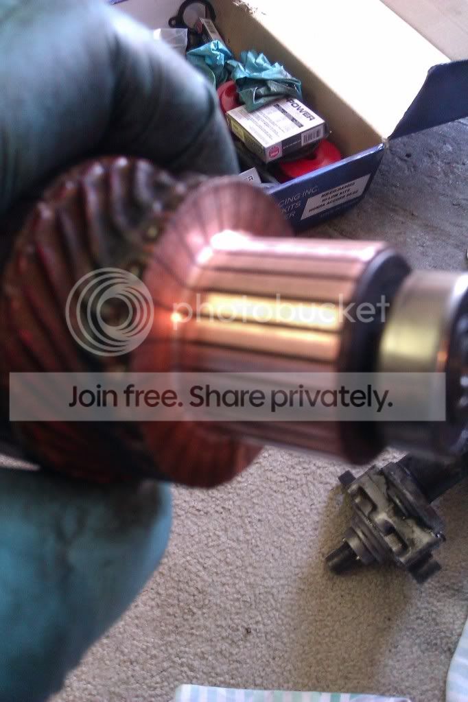

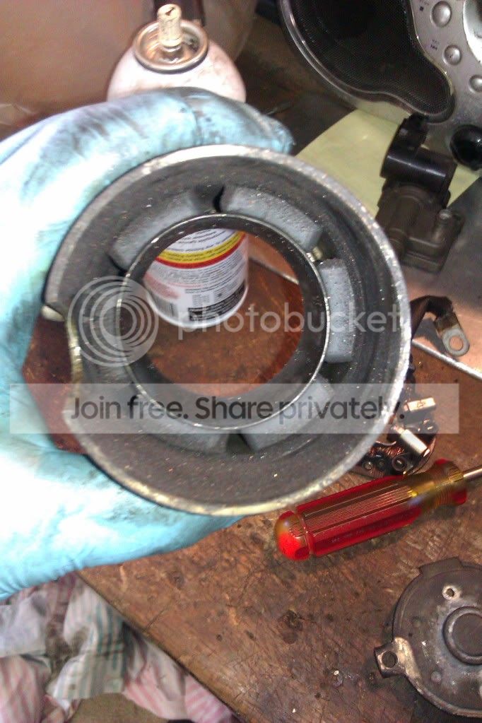

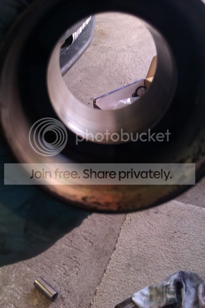

Step 7: Clean all the parts inside the starter so that it looks like it just came off the production line. (I do to make sure no debris ruins anything inside.)
Step 8: Use the 220 grit sand paper to clean all electrical contacts.

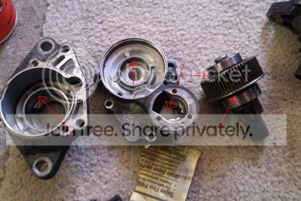

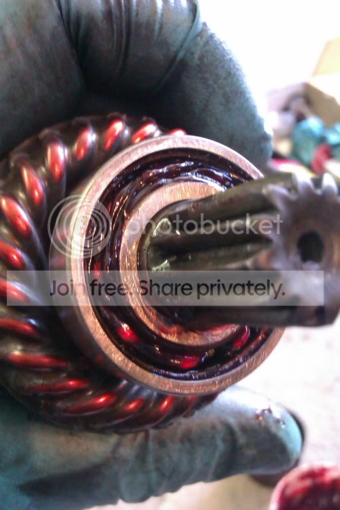

Step 9: REASSEMBLY!, make sure to put the new electrical brushes in there. And put some wheel bearning grease in a couple places to keep things nicely lubed. ill give you a few pointers on where to put them.
And if you did everything correctly your starter should work perffectly. If you have any questions feel free to ask....and uh rep please?
