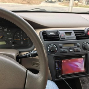

Here's my Vtec Light. Sorry for the crappy picture of it on, but that I took these with my phone while driving.
And I'll address this now, some of you will say that the bubble-letter "Vtec" is too rice :thinking: or something like that but it keeps the area from being boring to look at.
