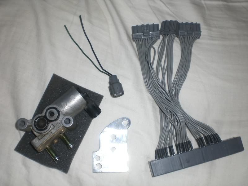

heres a pic of the adapter along with the iacv and plug..i already sold the obd2b-obd1 conversion harness..i still have the chipped p28 still for sale.
