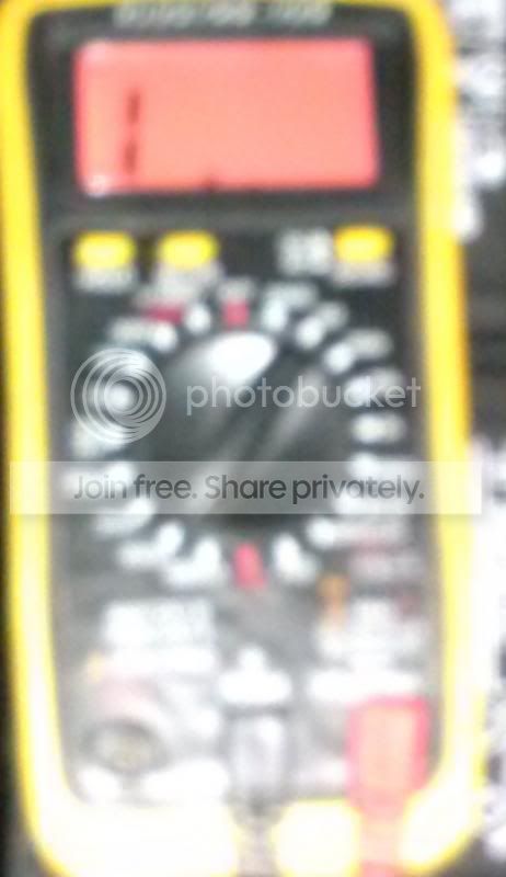

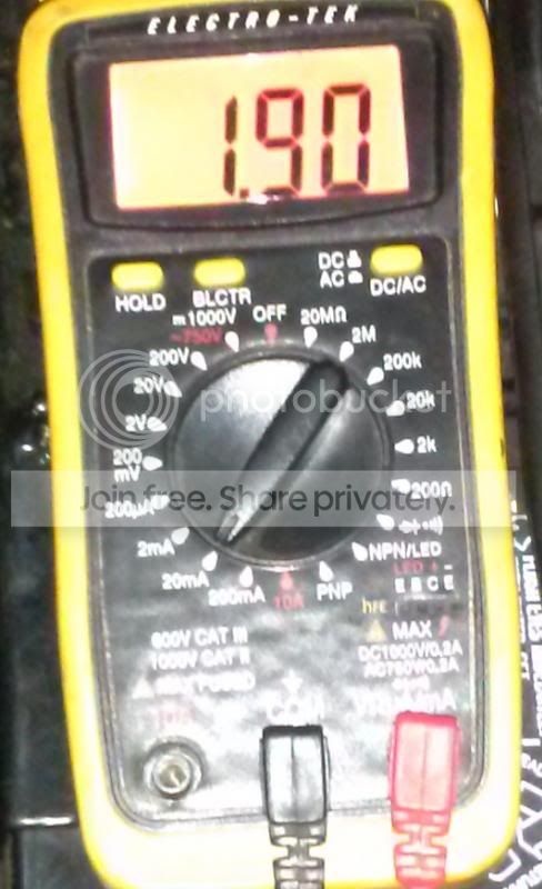

I pulled the negative terminal and ran the multi-meter in series across it, switched it to the mA setting and started pulling fuses.
Long story short: Only one fuse (that I tried) made the meter move. Pulling the 7.5a fuse labeled "clock backup" makes a measurable change. With this fuse out, the meter reads 1.90. With this fuse in, it seems to peg out and reads "1 . " with the gibberish spacing. I interpret this to mean "over 100."

The above image is with the 7.5a clock fuse IN. (sorry for the blur, it was cold and dark)
The above image is with the clock fuse OUT.

.1 to .3amp draw with a car off is normal. not really an issue till its over .8
have you had your battery tested yet? auto part stores can do a drain down test too

On second thought, don't you mean 0.03? Most of the stuff I see around the internet says ~30mA, which would be 0.030A? My meter was showing 0.3A with that fuse in place.
