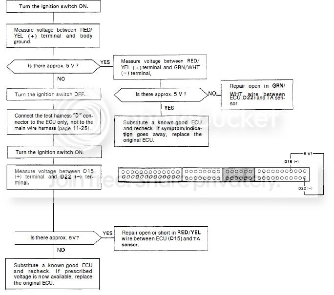

I have an F20B in my 2001 accord. Recently finished up some main parts of the swap and took it out for a drive. The car has 2 main problems, the idle is high (around 2,000) and when you drive it and you step on the gas to get going, the car starts to bog pretty badly. I'm getting CEL codes 14 and 10, which are IACV and IAT I think. I am using an H22a4 intake manifold so that I was able to solve the 2 pin IAC problem. Any ideas on why this might be happening?
