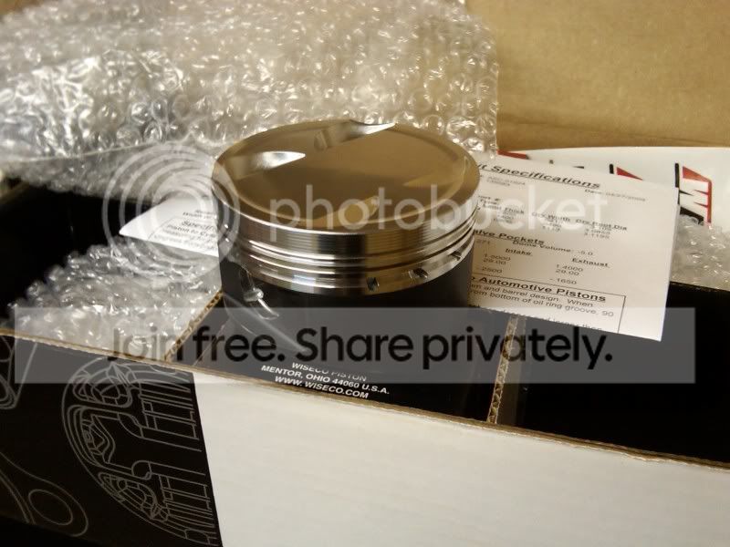

michaelp4283
Mar 27, 2009
195
Chicago
there they are. -5 cc 86.5 with the milling it should have a little over 11:1 compression.
