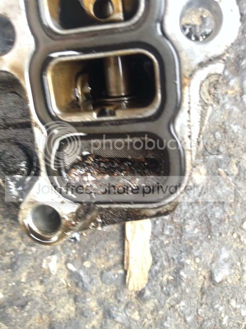

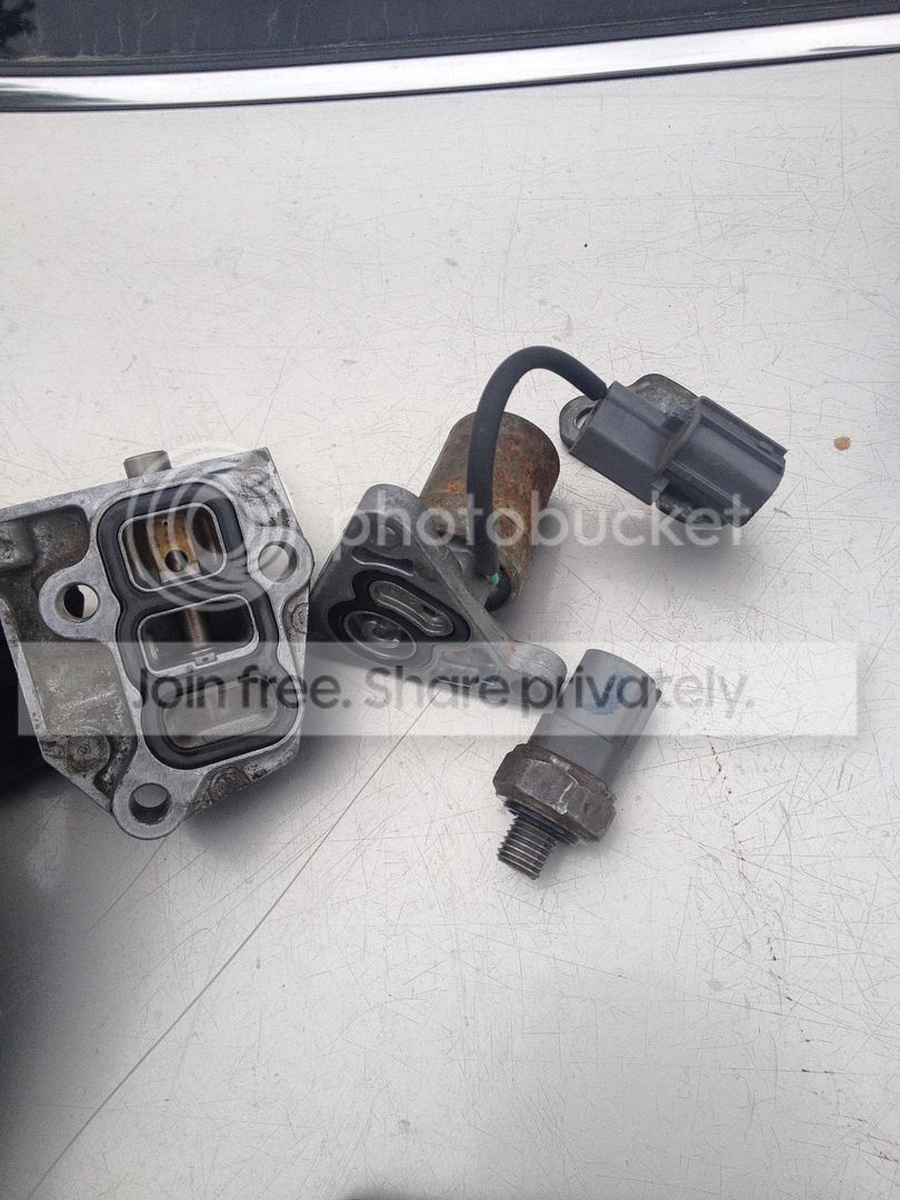

Okay , so I have a 1999 accord lx 5 speed.
It will throw the code p1259 or what ever code for vtec malfunction. and when i check the obd1 code its code 22(vtec oil pressure switch).
I have taken the old switch out and replaced it with different switches from the junkyard. still the same code.
So I pulled the vtec valve assembly. It had copper shavings in it. as well as other grime.
So, i cleaned that up and did an oil change, as well as change the oil pressure switch on the block.
welp, no luck there either. After letting the engine warm up with the new oil , it was dark gray/black again.
I took it around the block (less than a mile) and it threw the code. Before it threw the code it ran fine. as soon as it threw the code it ran really crappy.
It wants to die when you have the clutch in at stops, and it will die at stops.
It sometimes let you go to red line in first(when it doesn't rev limit you at 4-4.6k rpms), and in second it will either limit you , or only rev to 5000, and then not rev higher , and starts burning oil out the exhaust.
BEFORE
AFTER
