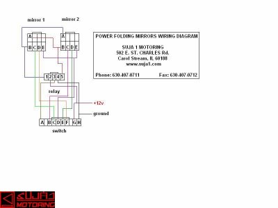

Those modules might have different pin outs but they should all do the same thing. do you have any of the wiring diagrams?

This is what i found after all day of searching

You could put them on a switch and relay. (3- SPDT 12V relays, and 2- 3 position center spring return switches.) Next you would need some type of sensing limit switch, but this might be built into the mirror, I've never seen them so I don't know.
There are many ways to make it work, but some experimenting might be necessary to custom build something.

We can use relay for a dc2 integra thats not as big an issue problem is to get it wired up.
Things can get much simpler if i can somehow get a hold of a wiring diagram for the CF4 mirrors and switch to know which wire does exactly what.
You could put them on a switch and relay. (2- DPDT 12V relays, 1- SPST 12V relay, and 2- 3 position center spring return switches.) Next you would need some type of sensing limit switch, but this might be built into the mirror, I've never seen them so I don't know.
I thought of that but having a bunch of electric relays and cut outs is never a good idea because then you have just as many chances of failure.
