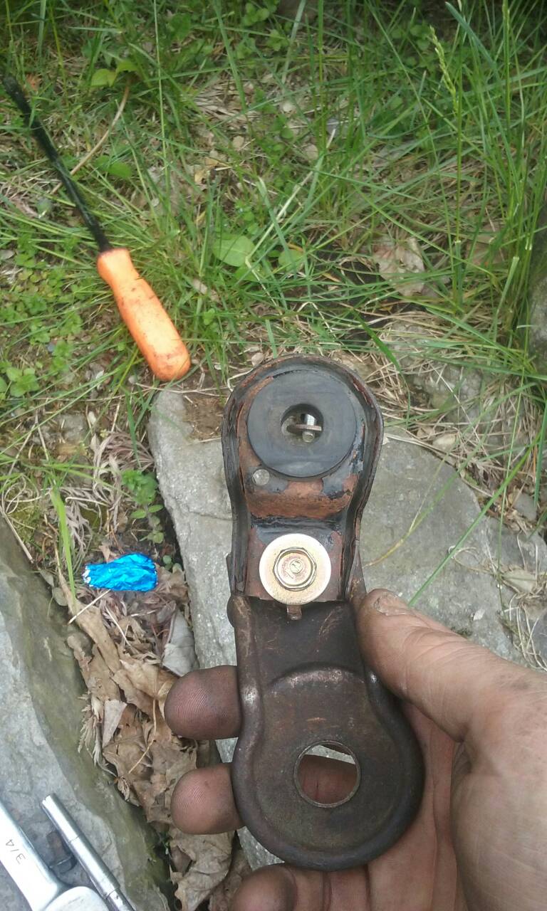

* Lower control arm (18X,XXX) (right)(bent)
* Upper control arm w/ball joint (18X,XXX) (right)

Ps: I added some funnies in the photos. Yes it fell off while I was driving.
