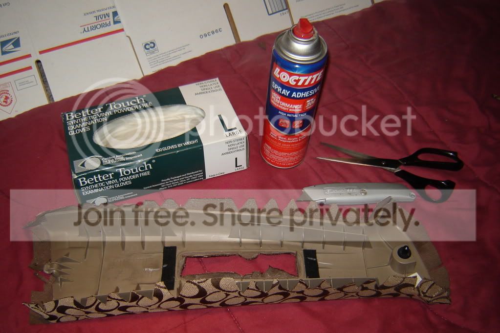

Hahaha yeah I posted those pics a while ago and was having problems changing my title so WILDMAN fixed it for me but will be posting some completed pics soon. . I used loctite spray adhesive. . Im going to post a DIY and ive got some pics of the can in it. . .

I tried the 3M heavy duty adhesive 1st and it was garbage for this project. . .It came out like silly string and didnt work at all but the loctite worked wonders!

Yea I would def recomend the loctite and will post the pics of it soon. . .The fabric I used was very heavy and thick and I couldnt believe how well it stuck together. I just kept peeling back small portions of it and spraying both the fabric and the headliner and worked my way through the whole thing. . .Honestly I found the headliner to be easier than all of the little parts. . lol:thinking:

Hahahaa yeah I hear ya there. . .there was a bunch of lil **** to take apart. . . I got the spray right by the spray paint at home depot next to a buch of glues and adhesives. . .I couldnt have been happier w/the product. The spray nozzle was covered in gobbbs of adhesive and it still sprayed nice and even. I love that stufffff!:crazyrun:

Heres that pic of the loctite in case it takes me a while to get the other pics posted. . .
