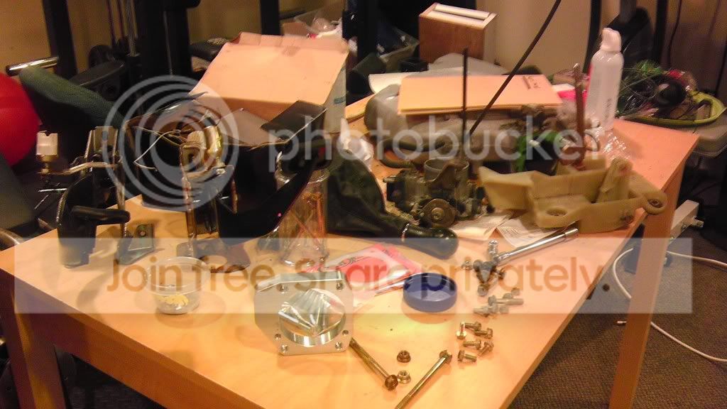

Some small things like my pedals, spacers, bolts, p2r stuff, richies harness, ecu, ect

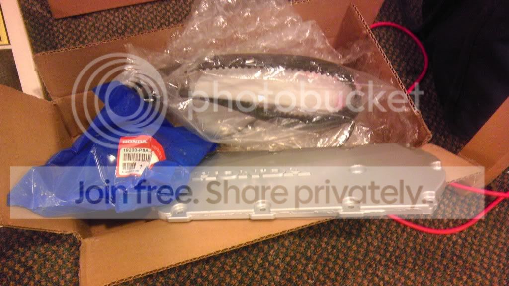

My 8th gen manifold cover rather then the acura one. Sleeper status yo. Also my water pump and timing belt

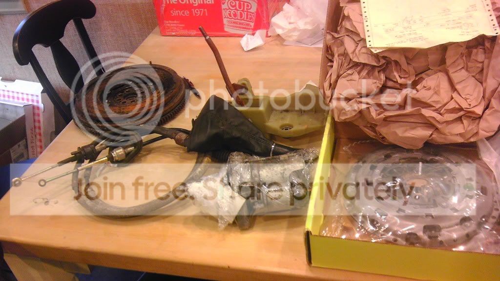

Some things I got yesterday. Cl s shifter assembly, flywheel, and a Tl starter motor

Some of those parts look like they could use a bit of cleaning up, but good to see you are getting all the stuff you'll need.
I think you're taking an extra step, I could be wrong, but for my planned swap, I am using the ECU/Harness from either the TL-S/CL-S(auto) and as far as what I have learned/been told, I don't need Richie's harness.
I guess because of the combo that you are assembling, you need it?
No you need it if your using an auto ecu. And yes the parts will be cleaned haha. I'm just making sure everything is Done right
