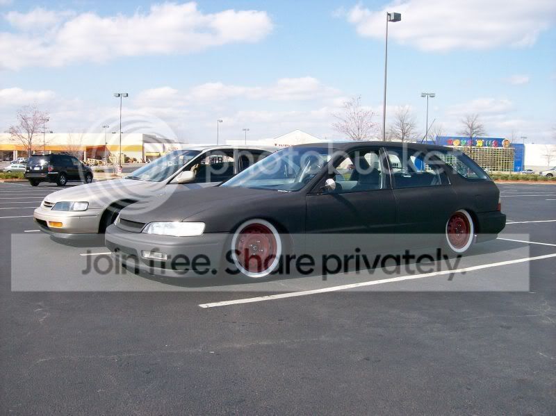

Has anyone seen the completed project of that car... and yeah could some one send me a list of supplys need to paint a car...???
that last pic is the completed project... its supposed to be flat black or primer color... the project was really cool when he did it...
That is really gangster ha, the red steelies and all!
u shoulda seen it when it had whitewalls... lol... its bagged and has a crazy soundsystem
