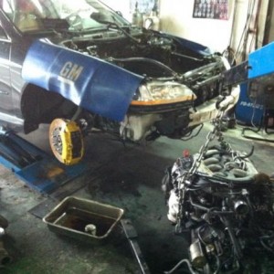

hello guys,
i am new here and decided to join the gang here cuz i actually just had done a h22 swap. now being new and all, was naive to the whole computer issue with the 6gen accords and wasn't aware that there was an immobilizer with the factory system. now the ecu that came with the engine was not helpful, so i was told to get a unique model of ecu meant for the 96 lude called the p13-a12. i have this ecu now and looking to install it asap, but i wanted to know from you all what i should be prepared for and if anyone has success stories with this swap. thanks
