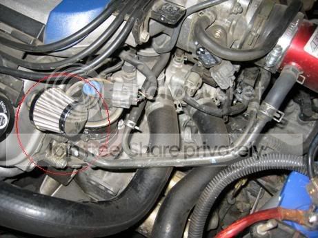

Well he put a sticker on the back of the ticket with a big smile. It says I have to take it to a state ref. That means I have to make an appointment. =/
Well here is a pic of what he supposedly ticketed me for:
Just took the picture of it now.
LOL i mean.. that hose is disconnected..
I dont think he took a picture of that though..

so if that is illegal i dont want to fight it, but miraculously if it doesnt affect emission lol i will contest.

well, i would say if AEM made their intakes with the extra tube on the intake to be connected to the place where the breather is, then it should be hooked up. having that little breather really doesnt do anything anyway.

Yeah it does have the tube, The tube was just hangin there lol. i had the breather there thats why. I just want to know if having the breather there is illegal or not.

idk, id just hook the tube back up. then you can go to the ref, be fine, and then if/when you get pulled over again, you really have nothing to worry about. outside of cali, no one really has to worry about all that nonsense, but i still even have my tube hooked up.

The tube needs to be hooked up for engine equilibrium - it's part of the engine vacuum system. The small filter you have installed is actually pointless since its hole is used for sucking air into the crankcase, which would naturally come from the cold air or short-ram intake if you had the tube connected.. plus as it stands now, you are getting hot air in the engine through that hole, not that it matters a whole lot.

since its a fix it ticket, and i still have to go see the ref. Would the cost of the ticket still be a lot? It's for vc 27156(b) modified emission.
And would they just check to see if I corrected the situation or will they smog my car too?

Wow, their strict in Cali aren't they? Well, the breather is illegal everywhere for emissions purpose.
