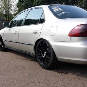

Dose any one have any ideas about moding a J30A1 Engine

Intake, UR pulleys. Not sure sure if modding this engine is worth it much really.

thanks for the picture, i'd forgotten what one looks like....
if you really want to get power out of the motor first things first you should swap the transmission, since that is by far the weakest link

Oh he said he already has intake btw. You can sorta see an sri or cai in the pic too.
