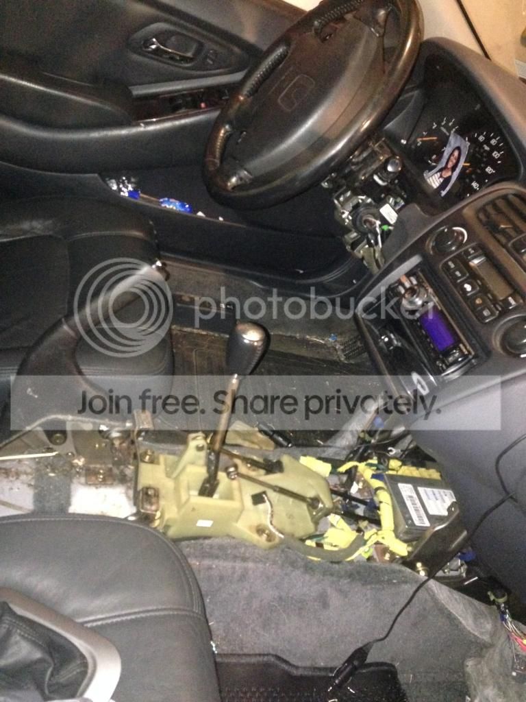

It only really needs fluids and wired up. I got the electrical connection ecu/pcm schematic for both cars from a local shop, and should have all the wiring figured out tonight. Then will do the wiring tomorrow, and hopefully get it started saturday.
I'm hoping I can find a local locksmith to cut a key to match my honda key but then program it off of the acura immobilizer

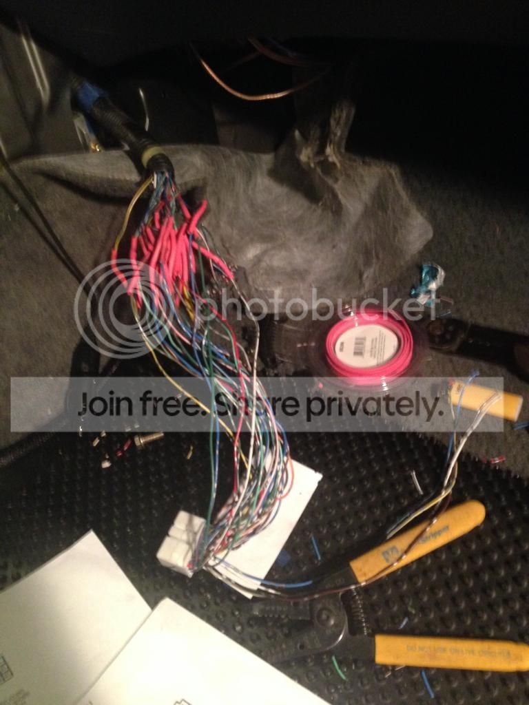

So I updated the previous link, and will update my original post after the swap and everything gets worked out. But this is what I came up with for wiring the ecu, still need to figure out what to do about the clutch switch ecu pin 17 on the CL but besides that I think I'm going to start wiring tomorrow.
J32A2 6MT ECU WIRING - 00 Accord EX V6

Today was a good milestone day.
So following the wiring guide I put together I spliced in the acura cl connecter.
Tried to start it using the ignition system, of course it didn't work because of the immobilizer.
I ended up going to Lowe's with the keys for both cars. Got a key cut with the accord pattern and coded with the CL immobilizer. The cut on the key is terrible but it got the ignition to turn. I only did the wires on the dash harness, no reverse lockout, no clutch switch, so it would not send power to the starter.
Took a jumper to the starter to crank over the engine, fired right up:ehcapt:, no leaks anywhere either.

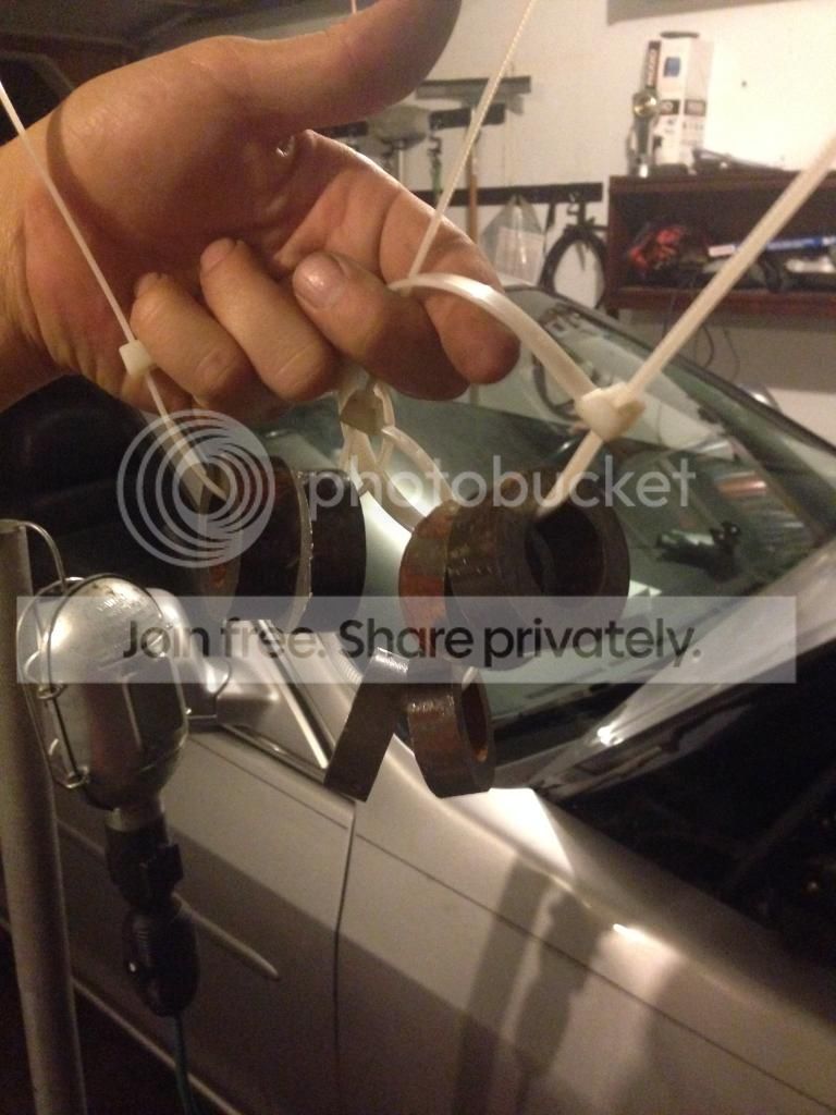

Spacer's I have, one pair is 5/8", pair of 11/16", and a pair of 3/4" starting with the 5/8"
Couple more Pics

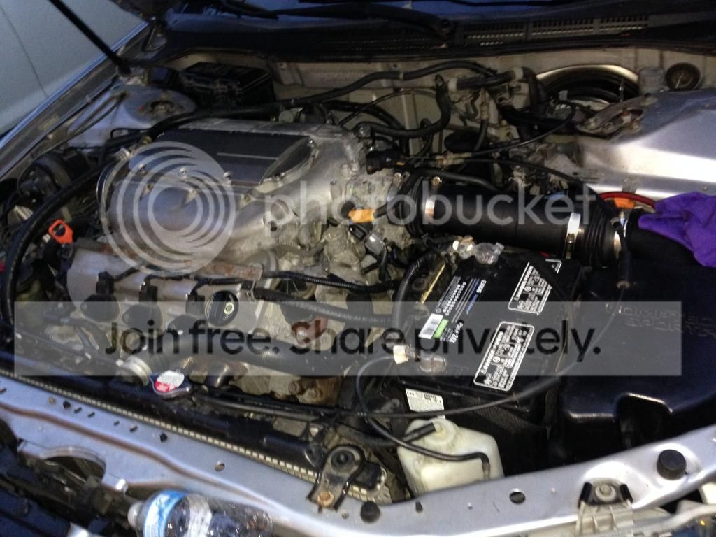

So the Greddy Exhaust pipe from the cat to the Y is about an 1" or 2" too long, so I cannot use it. Back to Megan Racing.
The surging idle had something to do with motor mount vacuum. Unplugged the vacuum hose, and connector to the solenoid, started the car, plugged it all back in, no more idle problems.

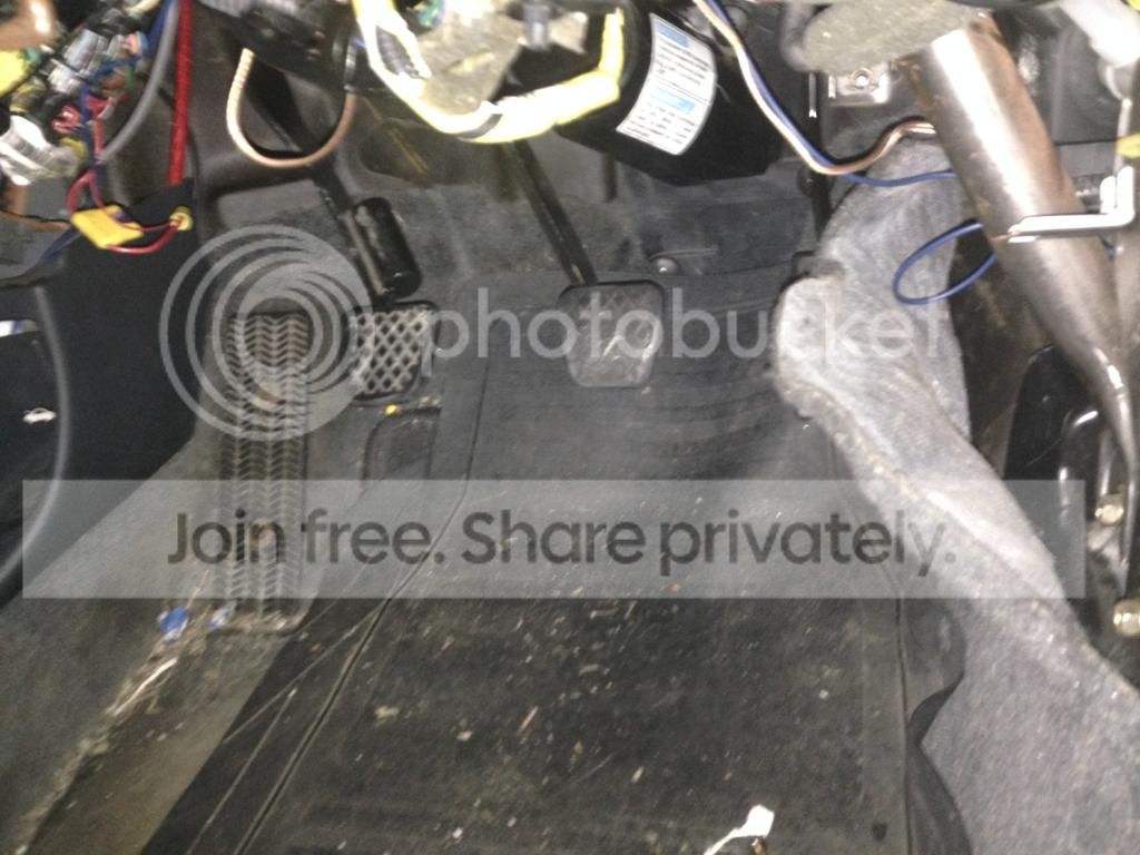

So the clutch interlock wiring, have it figured out. Connector E on the accord, pin 12, blu/wht wire. Stuck a paper clip in the back side of the pin, used some alligator clips and wired it so that the blu/wht on connector e went to the blu/wht on the switch and the ecu, used one of those paper clamp thingys to hold the black wire to the chassis, and started the car. No problems.
Car runs like a champ. Just have to put the mufflers on, actually wire in the clutch switch and put the interior back together.
The SRS light is on still. I don't know what to do to fix it. It throws no codes on the OBD2 scanner. Also, going to work on getting the IMRC Module, and Cruise Control Module all wired in. Most likely going to have to use the CL cruise control because the ecu won't be outputting a cruise signal anymore.
Using 5/8" Spacers

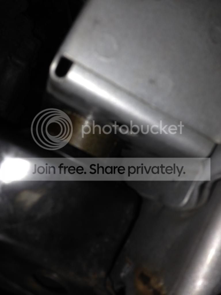

The hood closes and just resting on the intake manifold, I might use the 3/4" spacers for better clearance or order some motor mounts and cut them.
