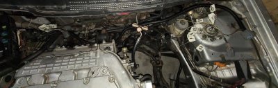

On the wiring, I will summarize by saying the 31pin plug e on the cls has maybe 3/4 of the same wiring and color coding going to the ecu as the 4cyl accord. I was able to cut and solder in the cl plug by matching the wires by function.
There are also 2 plugs on the cl engine harness named c101 and c102 that when you eliminate the A/T ones, carry about 17 other wires combined from drivers side engine bay thru a grommet near the master cyl, to the interior drivers underdash fuse box, behind the dash, to the passenger side interior fuse box, then to the ecu. While that doesnt sound like a lot, it is, when you consider there are maybe 2 wires shared with the 4cyl accord plugs; both of which are beneath the underhood fuse box on the opposite side of the engine bay.
First and second pics are of the 31p plug I already soldered in and taped up. The pink tags are labels on the non matching wires to identify the function.
Other pics are of c101& c102, I have yet to string any wires from those.
