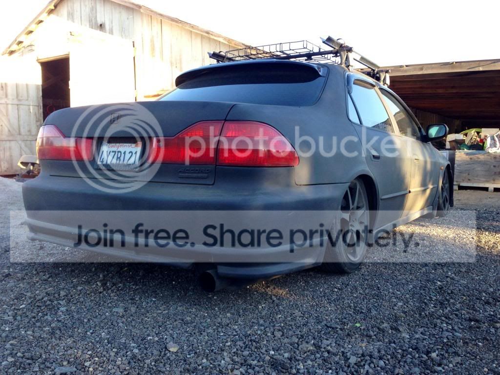

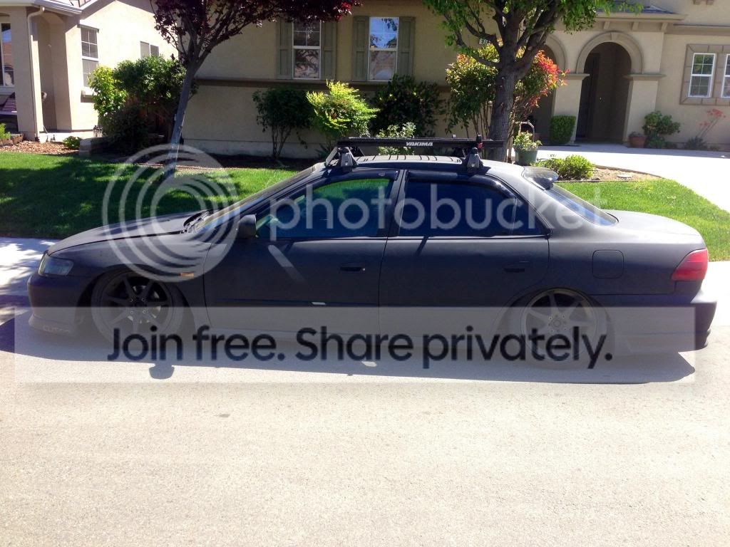

Yup :lawl: n I'm nowhere near flush my offset is 35
Camberd like a mother fucker
