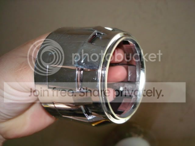

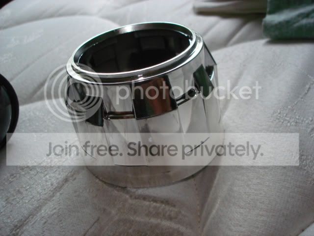

Any pics of the shrouds Darryl?

yeah, what about the light leaking out of the projector? with "sealed" projectors, looking at the headlamp...all you see is the circle of light and its niiiice :lawl:
edit: how much of the projector will those cover?
The entire projector. These are made for them. The shrouds are not in on the pictures. I have to trim them to fit our headlamps.

so i assume they snap on or do they have to be JB'd on?
Yes snap on. However they are too big for our housing so you either have to trim the shroud or trim the bottom of the reflector. I tried trimming the shroud but by the time you took enough off the shroud is way too flimsy, I ended up snapping one so for the time being I'm running shroudless until I get more time to pull the headlamps back apart.
