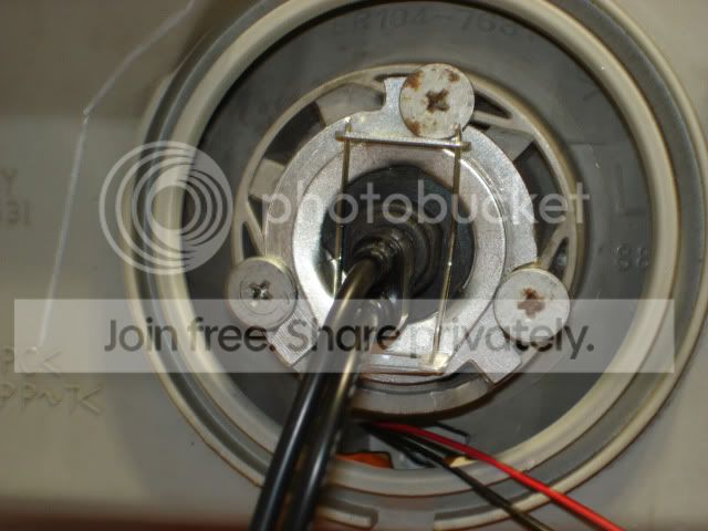

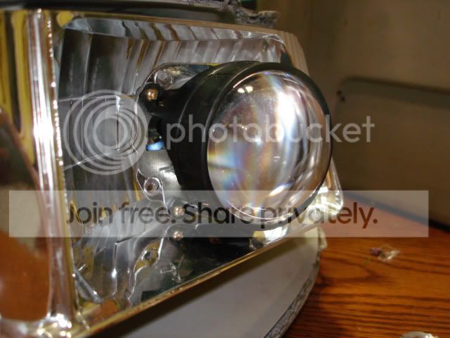

Mini H1's came in today. I have to work, but I'll see if I can't start tonight on them. The only thing I noticed is you'll need to pick up a 9006 connector if you don't make your own harness since most H1 HID kits just come with 2 male spade connectors. Thankfully my Kaixen HID bulbs have detachable 9006 connectors, so I just stuck those on my DDM H1's and it worked perfectly. The mini Gatling gun shrouds also SNAP right onto the Mini H1's no JB, Silicone, Glue required to hold them on. Also got my LED strips in, bright as hell. Should be installing those too. I'll have pictures of everything later tonight.
shavedaccord
Apr 15, 2006
5,678
20
Gates, OR

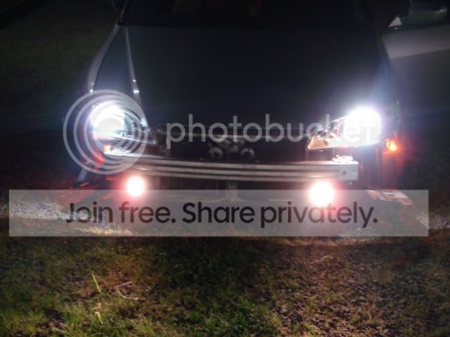

Got them 95% done last night. I just need to go pick up some wiring for the Bi-Xenon & LED's. Here is some teasers. These have NOT been aimed properly yet.
