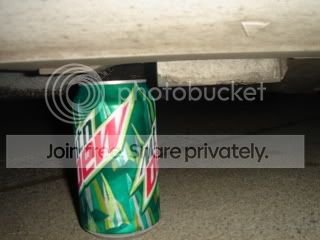

the jack points on the side behind the front wheels and if you're too low for that drive onto some 2x4's then try they'll look like this
the little tab beside the can
The tab you're talking about is where I usually put my jackstands. Is there somewhere else you would put the stand, then? I'm just super-paranoid about being under the car while it's only on a jack. Like, for oil-changes and stuff.
