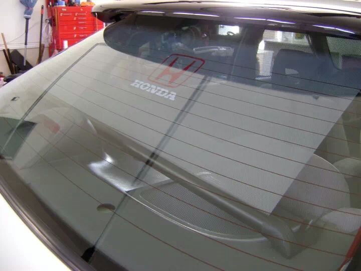

Although I've had a crappy week (refer to my latest thread), I'm excited about the being able to use the sunshade now. I finally rigged up some clips for the sunshade.
Bought a set of these from Target.
Grabbed some pliers and bent them into an S shape so they can clip onto the headliner.
Crappy looking but whatever. I plan to plasti-dip these so they look better.
Here's the end product....and my broken front lip behind it :sad:
Update: 05/02/2014
Just received it today and couldn't wait to install it. Took me a while to figure out how to mount the plates. Then I came to realize I had to cut a slit on the rear deck cover to accommodate the shape of the plate. Can't really tell anyway. The other end of the plate attaches to 1 of the 4 speaker bolts.
I have no pics of the install, unfortunately, but you should get the idea. Here's a picture of it mounted. I still have to figure out how to mount the hooks that were included but I might just buy my own hooks.

Tell me about it. After more than a decade and a half, you would think there would a discussion about it buried somewhere but a Google search yields nothing. But I just snatched a brand new one on eBay though... so excited! The owner never had a chance to install before he sold his Accord. These are the pics he sent me.
And apparently, Honda also made one for the 96-00 Civic with the Honda logo. Learn something new everyday...

I don't think there's any cutting involved.
From the looks of it, the hooks are shoved inside the headliner right above the windshield. And the plates are bolted under the speaker covers at the corners with the tab+bolt sticking out for mounting the ends of the sunshade.
