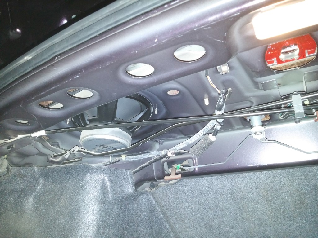

I actually have a picture of the job the dealer would have done back in 98 when the car was bought new.
full
If your wiring in the trunk looks like this its possible it was done by the dealer. It looks like the original harness has a new one connected in to it an reroutes back towards the left side of the car. There's even a part number on it but I can't make out more than a few numbers on it. It would then be attached to the trunk hinge and feed into the spoiler.
