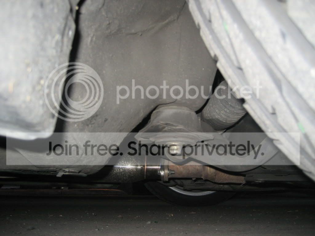

no the brace further back,that connects to your lower control arm rods and such..its right before the gas tank-so it makes it a easy area to mess up/slip.ha
:thinking:
Alright the red x is the gas tank. You mean the green lined black brace?
If not I might just try the tow hook. I never use my trunk anyways and it could use a redecorating :D
OOPS forgot the pic, here:

the rear tow hook :nutkick:
Agreed! I have just found out on the 8th gen accord site that they use the rear tow hook (the MANUAL even says it according to that site). I don't have the service manual so was just checking.
thanks!

This is the only place I use to jack my car up in the rear
And front:
You can also use the tow hook.
DO NOT put a jack under your gas tank or under your trunk.

i use the rear tow hook all the time. one time i accidentally used the area you circled in the first pic... i wasnt really paying attention, was in mid conversation with a friend. anyways yes it lifted the car, but it also dented the trunk in where the spare tire sits. i opened the trunk afterwards to put my tools away and the spare tire was pushed way up but luckily for me, i removed the tire and stomped on it a few times and it popped back into position. i narrowly avoided major damage.
