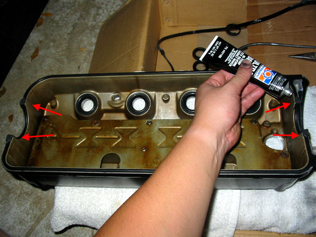

You will need to use Ultra Grey RTV silicone gasket maker (Permatex) on the four flat areas on the rubber gasket where the camshaft goes through the valve cover (on the short sides of the rubber gasket, where the half circles are). The liquid gasket goes on the bottom after you've fit the gasket into the valve cover.
Also, be careful when tightening the bolts. The torque specs are rather low: 7.2 lb/ft.
Liquid gasket only needs to be added to the rubber gasket where the four arrows are:
The rubber gasket is slightly wider where the liquid gasket should be placed. The liquid gasket goes on top of the rubber gasket after placing the rubber gasket into the valve cover.
The Ultra Grey RTV is an OEM match for the Honda specified liquid gasket. At least according to the packaging it is. From the service manual, you should use part no. 08718-0001 or 08718-0003 for the liquid gasket.
