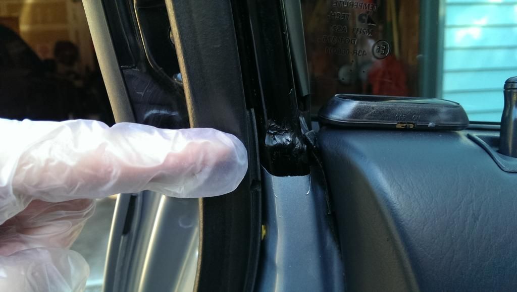

Decided to flatten out this section. It has been bugging me, ever since I had my driver's side door panel replaced, b/c it's making too much contact w/ the weather strip. (That black little thing next to the door lock is the anti-theft auxiliary LED indicator.)
This is the passenger side, in comparison. (Normal.)
Heated it up 'n hammered it down, but it didn't become flat...
Decided to shave it. (Thought it was a butyl rubber piece, but it turned out to be a bare metal.)
Didn't have a proper stuff to paint it black atm, so... Sharpie ftw for now lol. (Just realized that I do have a black spray can haha.)

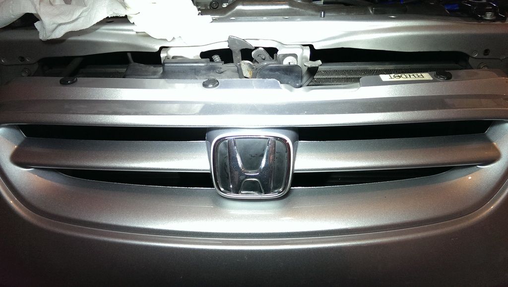

Plasti dipped the upper grille center bar black. Was a good timing to spend a day off on this, while waiting for the mufflers to be delivered in two days.
Cleaned the surface w/ mild soap water.
Masked off the desired section with good margin.
Slid a news paper 'n taped it behind the grille.
Didn't have to mask it entirely, but just for the hell of it. Lol
First coating. (Very lightly.) 30 min drying time.
Second coating. (Semi-light coat.) 30 min drying time.
Third coating. (Thick coat.) 40 min drying time.
Fourth coating. (Thick coat.) 40 min drying time.
Fifth coating. (Heavy coat.) 50 min drying time.

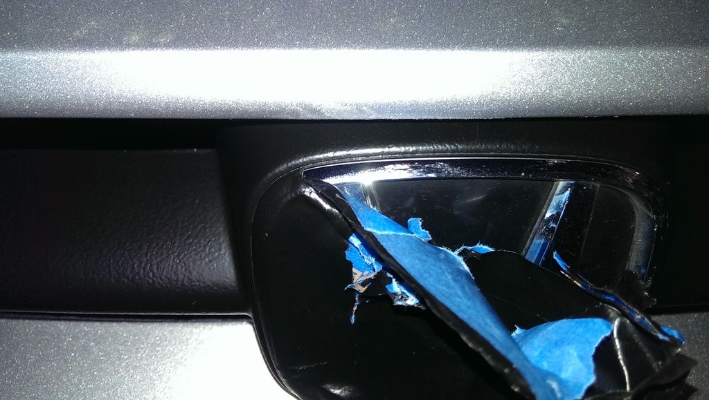

Also, dipped the license plate fastener caps to match with the smoked plate cover.
Incising it carefully.
VERY x2 carefully...
Done!
A little close-up.
BEFORE:
AFTER:
BEFORE:
AFTER:
BEFORE:
AFTER:
Hopefully it will hold up for a long time, like my side window trims. It has the thickest coatings I could possibly applied, so we'll see how it can withstand from rock chips.

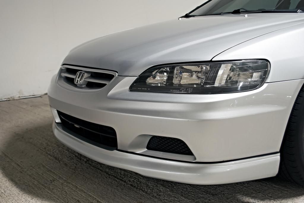

(Here's the super subtle cosmetic work that I couldn't do, when I was dipping the center bar last week.)
Well, my stock upper grille looked "cheap" from my point of view; It's b/c the grille is in one-piece w/ the bumper being '01-'02. To me, the outer frame of the grille looks integrated too much w/ the bumper, and I wanted to sharpen up the trim distinctively.
Bought this piece of black tape, when I was visiting Japan last year. ← (Yea, it's JDM, but nothing special lol. I'm sure our local auto parts stores carry the same kind as well.)
Cleaned out the surface and taped it along the line of the trim.
Didn't have to use the heat gun or anything, since the curve wasn't that sharp.
It's very hard to tell from the distance, so here's before & after:

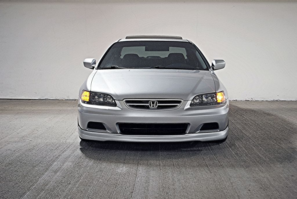

Mounted the front license plate, since it has been a while w/o it, yet not being pulled over. I tightened the bracket too much, so the plate is kinda warped. Lol But I'm finally happy w/ the front-end now. ..., For now. :p

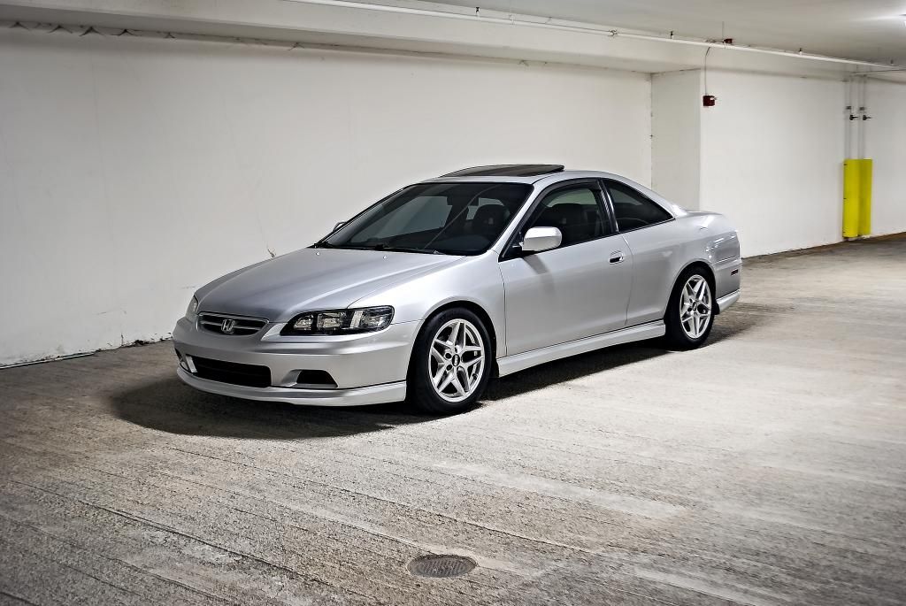

Well, this is how she sits as of now. Car's dirty, but went out to take a snap anyways.
The mufflers will be installed next week. ;)
