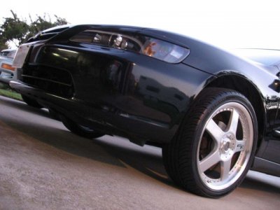

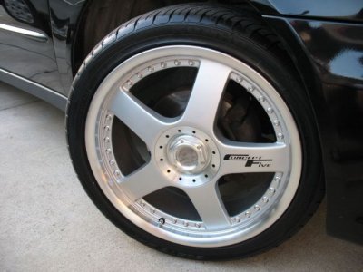

do u guys think it's a good idea if i lower my car a lil? cuz i got 18x7.5 +42mm and it lines up perfectly under the fender or maybe a mm more out? but i just want to make it look more proportional...a bit too much space...
