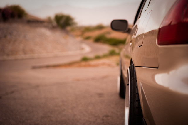

I'm 9.5 +21 in the back and they poke a little, im running natural camber around 3.some degrees
