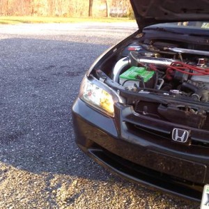

So recently I just replaced the high pressure steering hose bc that was leaking and now I noticed my brake fluid is leaking and it turns out the hard main lines from the front proportion valve to the rear brakes (not sure left or right) are rusted and leaking. Those 2 little lines share a runway (covered by that black plastic track) with 3 fuels lines (5/16") and they also look corroded. So I will be replacing those as well. The joys of owning a 209xxx miles, 2000 3.0L 2 DR lol. I've ordered the hard lines for the fuel lines from linestogo, a canadian company and the SS flexible brake lines (blue PVC coated ones) from ebay. Wish me luck!

All done! Took most of Thanksgiving day, a little Friday and some Saturday but here is the result:
https://imgur.com/a/QPeVUZB
-I wasn't 100% done in the video. I need to put back the metal bracket in the rear. It didn't fit so I had to flatten out the metal harness and then zip tie the plastic track to it but everything is quite secure. Just did a test drive for about 30 miles, all good!
-New fuel lines (vapor, supply and return all from a canadian company called linestogo)
-blue flexible SS rear lines from Ebay
The brake fluid is now absolutely brand spanking new.
It would appear that a couple of the fuel lines are discontinued by honda and I suspect that those lines are probably never meant to be changed during the lifetime of the car for most people.
Accord lives on.....
