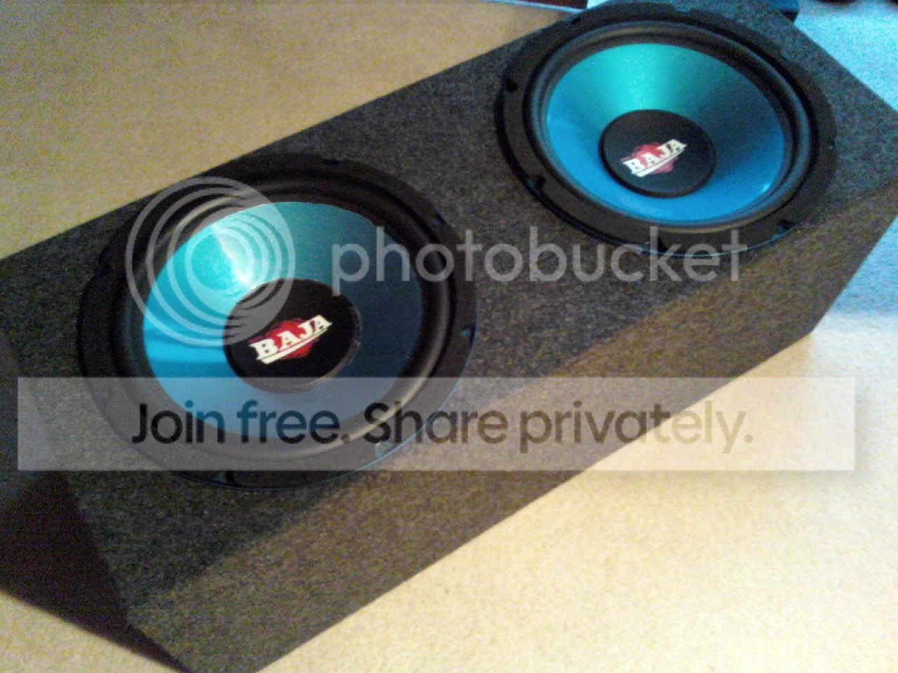

Here is a pic of the setup, subs aren't secured, just resting on top of box:

To the OP, you should probably redrill the holes. I usually drill them with a 1/8" or 3/23" bit and then use black finish countersunk square drive 1-5/8" decking screws to hold them in.
Box is brand new, no holes drilled. Should I still drill with what you said? And is there anything I need to put in between the sub and the box?
ALSO, to those who build boxes, it obvisouly came sealed, I don't know what with, but I would like to go over all the seals again. What should I do it with?

Yes, but drill as far away from the hole as the holes in the sub frame will allow (they usually have oval shaped holes). Don't put anything in between, in face what I would do is put the sub on there and then use and exacto or box cutter and remove the carpet around the sub so you get a metal-to-MDF seal. Basically trace the sub with the blade.
You can seal it with liquid nails or 100% silicone caulk if you'd like. Make sure you let it cure before sealing it up as well. Just throw a bead of it along the seams and smear it in with your finger tip.
Depending on how the box was built, you might want to put some extra screws where the MDF panels meet, just to be safe. You'll have to figure out how the panels overlap though. A lot of premade boxes are stapled and not sealed, like QLogic.

I understand what you're saying about drilling away from the holes, and i'll see what I can do about cutting away the carpet. Speaking of the carpet it matches my trunk almost perfectly, fits perfect too. I think we have plenty of caulking so I'm planning on doing that on all the seals when I get time.
