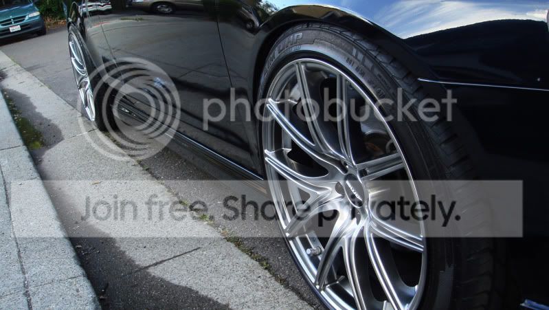

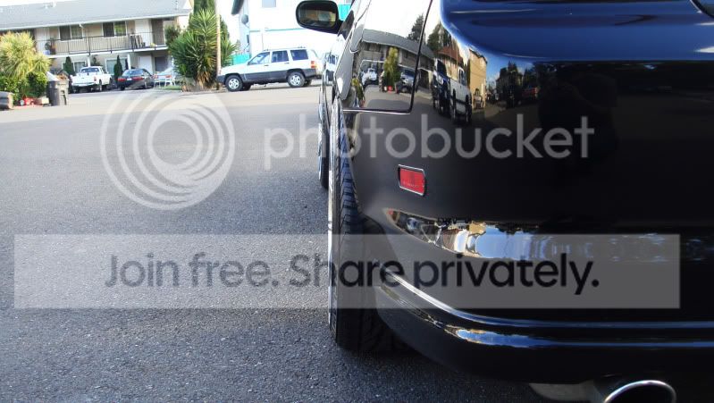

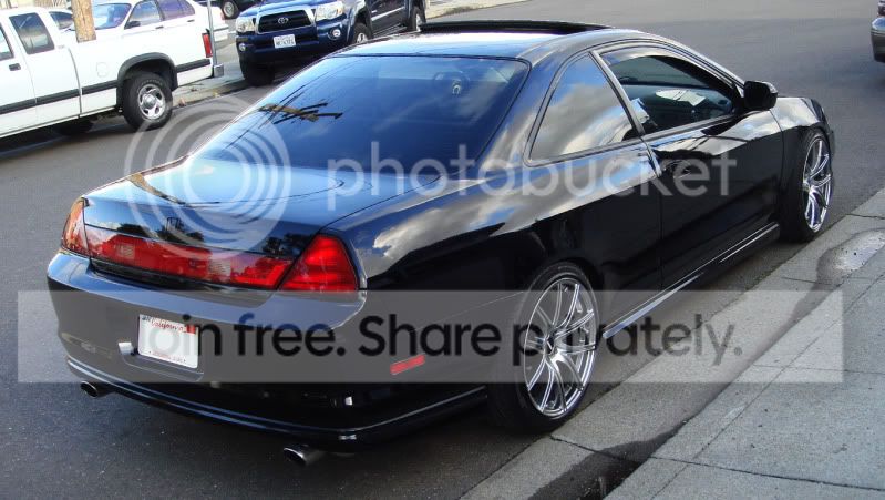

and here... we... GO...
-2 camber all around
5mm(maybe more) spacers coming soon for the rear
going up my driveway... zero rubbing
Specs:
18x9 +31 AME Tracer FS-01 all around
225/40/18 General Exclaim UHP tires all around
-2 degrees camber all around
all fenders rolled
significant work in rear wheel well
front fenders pulled ~3-4mm
rear bumper screw relocated further back
bumper shaved
metal behind bumper cut off ~ 3/4 inch back
lots of shaving and smoothing
brand new ingalls front control arms cut, shaved, repainted to minimize inner fender contact.
Specs:
all fenders rolled
bumper shaved
