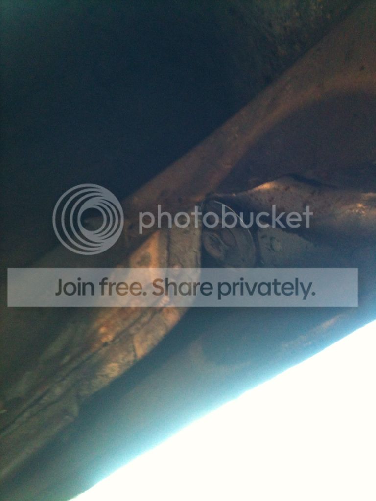

It's where my finger is directly behind that part of the fender
Up underneath this is what it looks like. There a metal ridge that juts out from the fender well. I hammered that down flat and drilled a hole about four inches back from where th tab was previously.
Here's another view. This time i took a pic of where the factory tab would sit right at the bumper and fender gap. The bolt isn't even in this pic because that's how far back you hav to relocate it if you don't want to rub.
