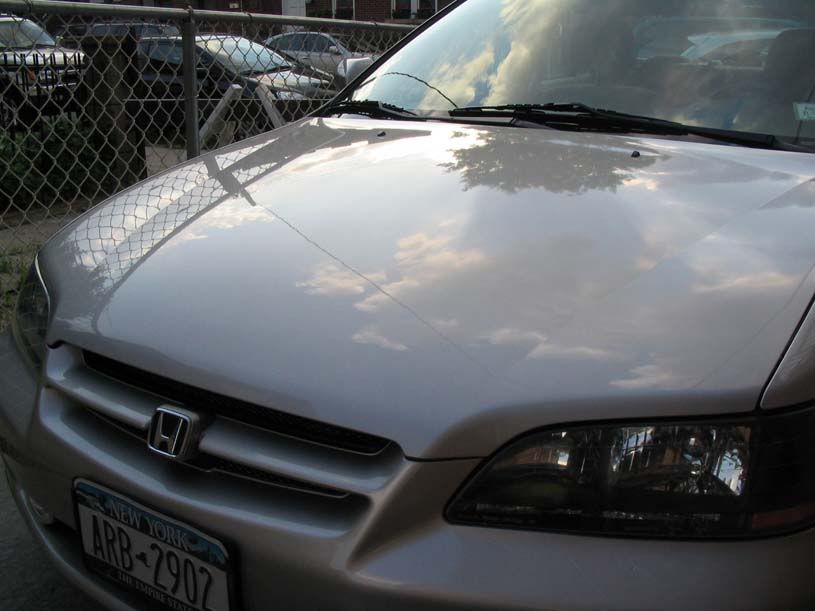

Just waxing dont do more justication. You need to polish with rotary or a dual action orbital. Also you need to clay it once or twice a year to get rid of oxidation,saps,etc. Once u done all that. You need to seal it and top it with any LSP(last step product) I do this on weekend for last 7 years, I detail cars another word :) You can find alot of stuff on autopia.org
Here's just few pics.
Beads :eek: I use JeffWerkstatts w/Fk1 2180 and top with FK1 PinkWax
Looks good. I see you're a fellow Nyer with the same color Accord as me. Where in NY are you?
Just south east of you. Im in Bensonhurst, BKN.
