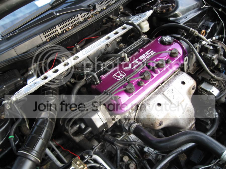

so I got a few questions that I need answered.
1. How important is the vacuum line that runs from the back left of the valve cover to the intake piping? are any of you turbo guys running that line to your charge piping?
2. where do the two vacuum lines off the two wire IAC go? theres one that points up and one that points down.
3. still haven't gotten a definite how-to for wiring the IAC, I'll be using the two wire plug a the 5th gen accord.

Re: UPDATE!!! [3-8-11] x5carl3tmurd3rx's Turbo build
i know when i pulled my iacv out it had 3 lines. one that went to the throttle body another going to the valve cover and the other i forget
thats something you should ask nikita, he did the swap

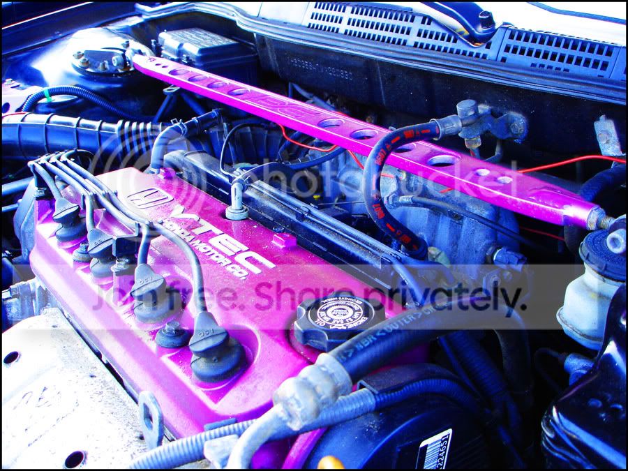

Dont know if this has been asked yet, but did you get your motor/trans bead blasted too? Or is it painted? Looks flawlessly clean. I wish I would have done something to my block to keep it looking fresh when i had it rebuilt. Aluminum just pits and corodes so easy and looks gross after awhile. Never the less, good work my friend. Looking forward to the final completion.
ya he called me earlier so I think its all figured out.
it was hot tanked a few times and then we brake cleaned it and then painted it with vht flat aluminum. it looks good but you gotta get it really clean cause there's spots on it that look like **** cause there's some dirt built up under the paint.
You don't want to run the hose from the back left of the VC to your charge piping. That is for the PCV. You can throw a breather filter on it or get a catch can of some sort.
