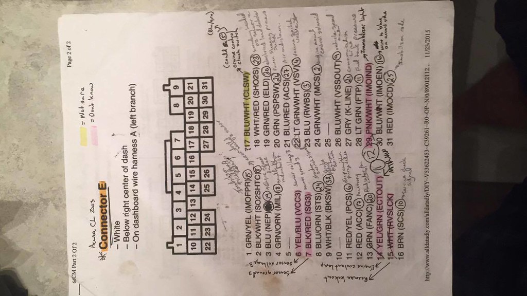

So I talked to quite a few of the OGs with this swap, and I'm going to try to compile all this data.
This is in regards to this picture.
J32wiring by Evan Aschbacher, on Flickr
It says start with Pin #1. Pin #1 is not there for 98-99 Accords. So do not do anything here if you are a 98-99. Pin#1 is the very top left of the plug, I'll also throw the diagram in here too. The only reason I bring this up, is because there is #1 stamped on the very right side of the dash harness plug. And this made me think I was doing everything wrong. It will have numbers on the plug (1, 11, 25, and 32), ignore all of these. I have no idea why they are there. All they do is add confusion. So start with the wire next to the blank pin#1 slot on this diagram, which is pin #2. Do not do anything with pin#1 with the Accord harness if you are 98-99. I will bring up what to do with the wire below.
1.) The 98-99 Accords do not have a wire that goes into the #1 pin (top left) on the dash harness. #14 on the E-Clip from the CL Type S Manual Dash Harness is supposed to go here, but cannot. So this wire goes up to the temperature sensor on the right-most plug to the yellow/green wire and gets spliced in. This wire goes into a coolant temperature sensor on the TypeS, which is not available for the 98-99.
-----So to get around this, grab the coolant temp sensor from the J30 coolant housing and tap the J32 one. Then wire it to the yellow/green wire on the right plug of the gauge cluster. I will test this and let everyone know if this works.
2.) When installing your clutch pedal, make sure you have a yellow sensor near the top of the clutch pedal. There are two pins in here. One is for the neutral safety switch and the other is a ground. The top pin is the neutral safety switch, the bottom is the ground. Once you have the wire going from the neutral safety switch to the ECU, splice in another wire to the drivers side multiplexor.

4.) I've also been told that on the 98-99, you need to run wires to the fuel pressure sensor. If you do not need to pass emissions, you do not need to do this. I do not need to pass emissions, so I will not be doing this. But I will leave a picture of what I was sent about this.
While trying to find a wiring diagram for the Accord V6 dash harness online, I nearly went insane. I spent a good 4 hours searching with different keywords, different phrasing, etc... Never found one diagram on Google. You will however find 4 cylinder F23 diagrams, Odyssey diagrams, and just a ton of different Civic ones. None of these I needed. So finally after giving up, I had some sent to me by Steven. You can find the CL-S one on J32A.com.

CL Type S Pinouts E Plug (dash harness to ECU)
-Steven's notes

To clarify on this picture, the black arrow is pointing at the clip where you match the wire up. Should be 6th one down, but I'll check and be sure. Photoshop is not letting me turn arrows for some reason, so that's why this one looks weird.

The pic is less blurry on here. Not the sixth place down. Looks like the third one down. Great write up. Captions really help.

On the wiring side of things, I posted a picture saying that the 6th space down is where the neutral safety switch wire goes. I was wrong. It is the third space down on that connector that is pointed at. I will fix this and repost it.
