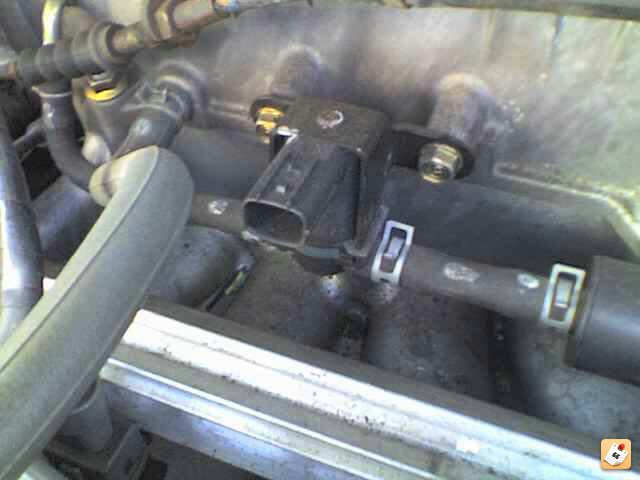

Does anyone know wat this sensor is its on my f20 but not on my h22 plenum

Its the start injector! B series engines dont have it either. Also another thing that doesnt need to be plugged into the p28 to start the car

i know when i got my car tuned we unplugged it because it was messing with my afr.
